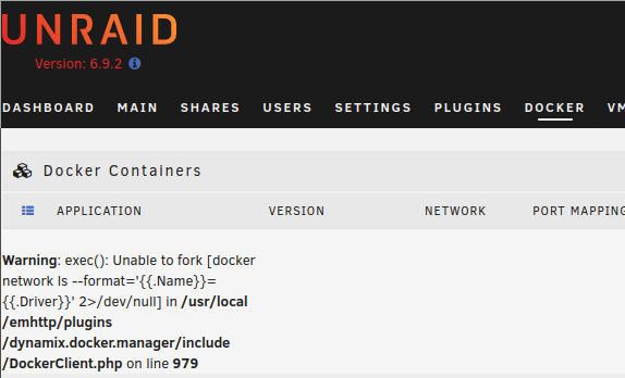

When visiting the Docker tab I sometimes stumble into an error message:
Warning: exec(): Unable to fork [docker network ls --format='{{.Name}}={{.Driver}}' 2>/dev/null] in /usr/local/emhttp/plugins/dynamix.docker.manager/include/DockerClient.php on line 979

But the main issue seems to be DockerClient.php line 979.
