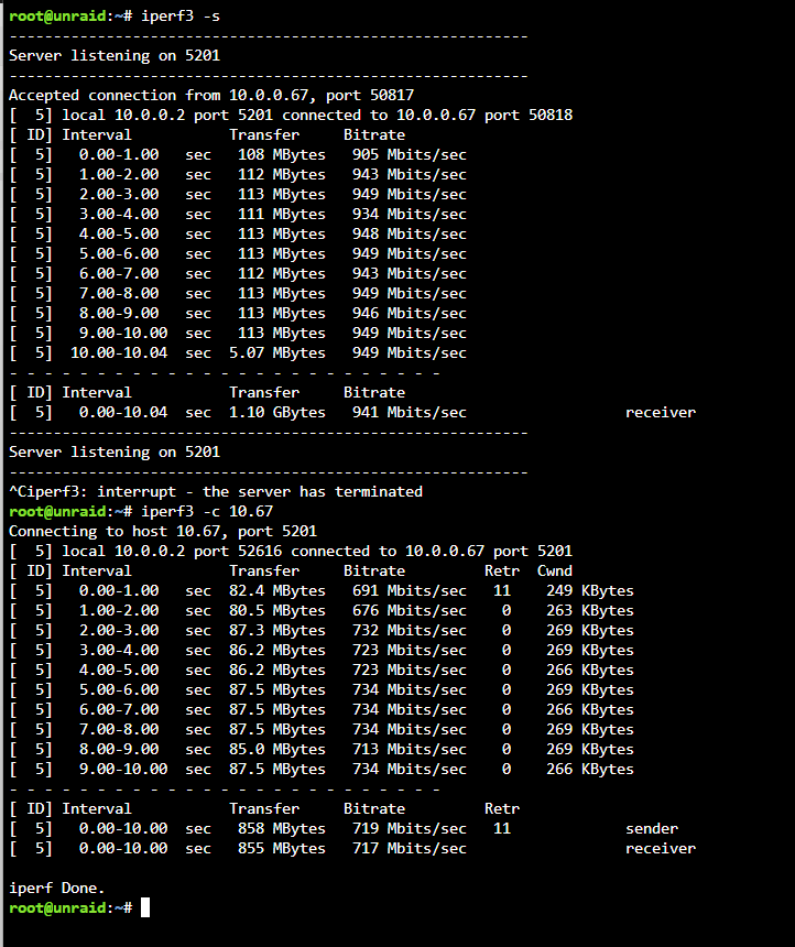

Start by doing a single stream iperf test in both directions.
@JorgeB
seems better but not perfect.
i can guarantee that it is possible to push 1G over that line!
Good in one direction but not the other, this is usually NIC, cable, switch related, could also be NIC driver or settings or a problem with the client OS.
i dont have this problem with the exact same setup in truenas or proxmox. didnt change one thing after reinstall
Iperf is OS independent, but the driver used in Unraid might make a difference, there are also some NIC optimizations you can try with for example the tips and tweaks plugin.
