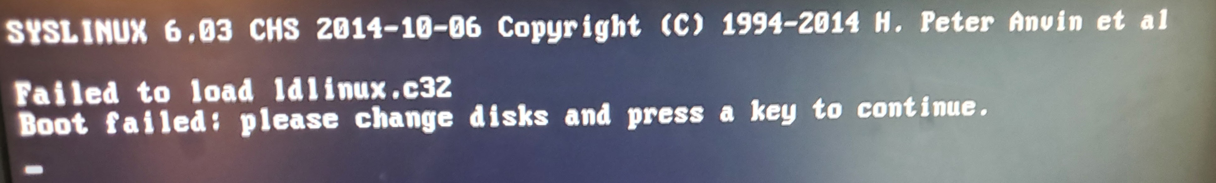

I just wiped the flash drive and tried again. This is what I get with those options:
That suggests the flash drive was not correctly created, try with a different one, just with a new install, don't restore anything, just to see if it boots.
That did the trick! Didn't occur to me that my new USB may also be bad, but third time's the charm! It worked immediately with my first method of simply copying over my backup and running make_bootable.bat. Whew!
