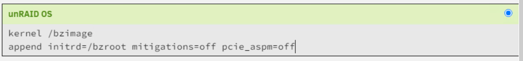

Sorry I'm a bit of a noob with Unraid but where exactly is the sys configuration file that I need to add pcie_aspm=off to?
Click on the flash drive and add it to the default boot option, like this:
Then reboot.
P.S. just noticed thy I linked the same post twice above, if you need to suppress the error it's here.
Then reboot.
pcie_aspm=off did the trick. Thanks a lot!
