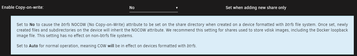

So I took a look at the "domains" default share on my Unraid server and the setting was "no" on COW.  I don't believe I updated that myself, so should I change it? The recommended settings are to have it "off":
If I do change that to "Auto", do I need to adjust the VM disk files already in the share? UnRaid's info there indicates that the nocow attribute is set per file and would have been set to "no" on the vdisk images themselves. If they are set to "Auto" is there a problem, or just a performance impact (and how much of an impact)?

You'd need to move the data, re-create the share with cow=auto and move the data back, VMs must be off during that.
