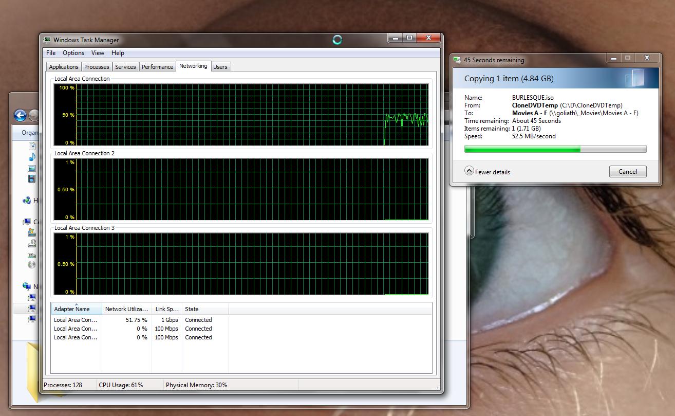

Ok so Unraid is up and running as my new production server, WHS has been retired (for now) I was transfering some large iso's to the server and running speed tests. Server is not running a parity drive at the moment and all drives involved are green drives. I am avg 52 - 60 MB/sec utilizing about 50% of the gigabit network as shown by the attached image. The network was otherwise unused. Is this as good as it gets? I am not complaining, just curious.
Also when I add the parity drive and a cache drive is there any benifit to going with a 7200 rpm cache drive instead of a green drive or will speeds likely not increase above my current results?

That is nearly top speed and is excellent! Adding a 7200 won't help unless you replace ALL of your drives - not worth it.
Those speeds are excellent :)

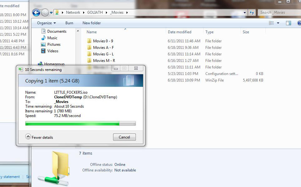

Just a little FYI, I found a thread here about slow copy with win7 related to Remote Differential Compression, so I turned it off to see what happened. My xfer to the server jumped to 75MB/Sec
Amazing little tip Attached is a screen shot
