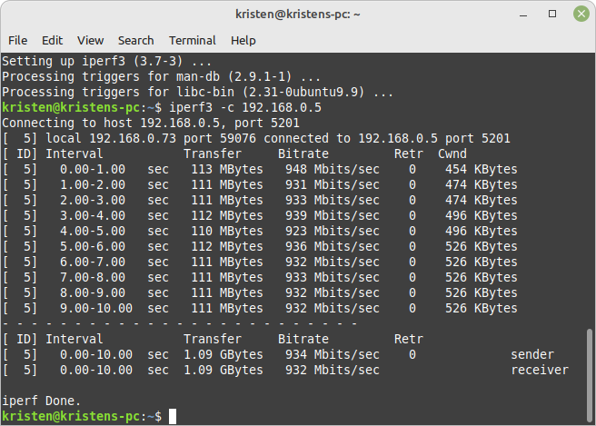

September 30, 20224 yr I have confirmed I get near line speed with iperf. 970 down and 850 up. However no matter if I use an SSD cache or an NVME cache, I can only transfer files to my server at about 70MB/s, which is about half line speed 500-550mb/s I can't find the bottle neck. Help? Am I just expecting to much from such an old machine? nas-diagnostics-20220929-2339.zip

September 30, 20224 yr Community Expert 6 minutes ago, Kuleinc said: The iperf tests indicate the network switches are not the problem right? Assuming it was a single stream test yes. 6 minutes ago, Kuleinc said: I guess I could change one and test it? Yep.
September 30, 20224 yr Author I pulled a 9.5 GB file off the array to my local machine at 75-80 MB/s and when I copied it back to the array is was about 70/73 MB/s whats the command for single stream test? Want to make sure I did it right. I think I followed space invader ones video... Edited September 30, 20224 yr by Kuleinc
September 30, 20224 yr Community Expert That is single stream, multiple stream can give erroneous results since it's doing multiple tests at the same time.
September 30, 20224 yr Community Expert Everything limited to around 70MB/s independent of the device used still suggests a LAN issue, despite the iperf results, do you have another NIC you could try with?
September 30, 20224 yr Author the server has four ports, I have two hooked up in fail over mode, would this cause the issue? This PC only has one 2.5GB nic running at 1GB, as I dont have any 2.5GB switches. I could try my PC downstairs. it only has a SATA SSD though... Is there another network throughput test I could run? I have to run and service my bobcat and start laying a gravel road for a neighbor... I'll check in again when I'm done. Edited September 30, 20224 yr by Kuleinc
