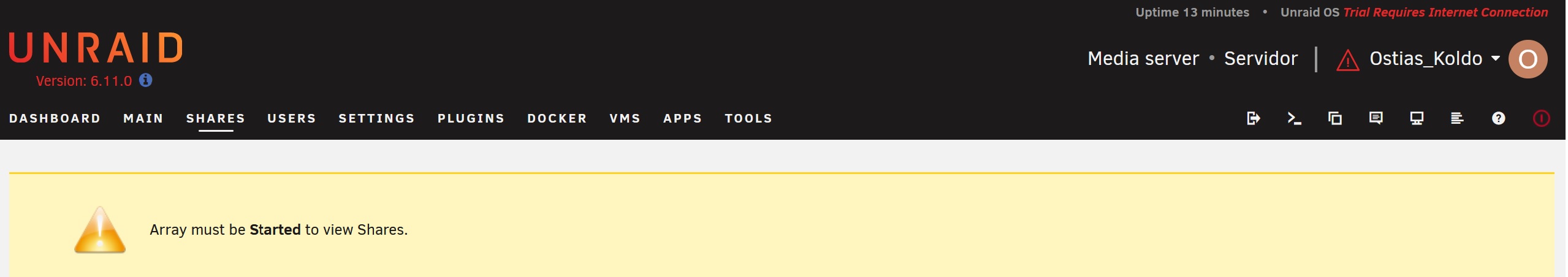

Hi! I've been using unraid for two days and today my server doesn't connect to the internet, so it doesn't have access to the Unraid server. I am using a trial key and without internet access the array is stopped. I have tried different options that I have found in the forum and none have worked for me
Can someone help me?
Trial keys require internet access to start the array, purchased keys work without internet. Otherwise people could use a trial forever.
