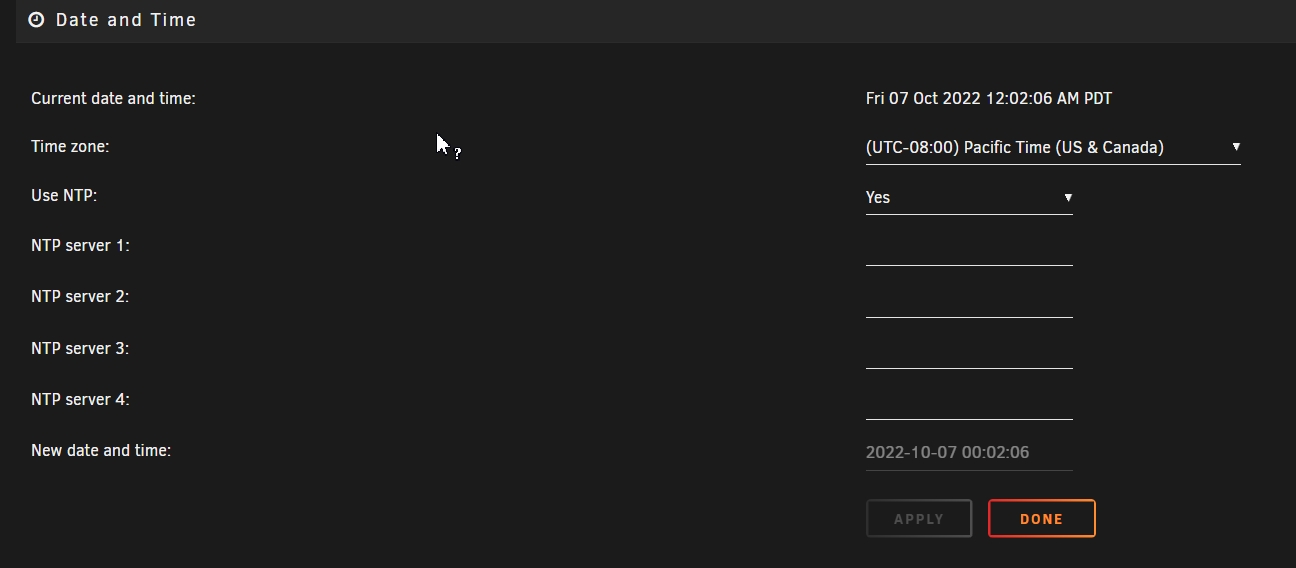

Since upgrading to vs. 6.11 the time is not displaying correctly. I have checked the date and time in the bios and it is correct there, but not in Unraid. NTP is turned on. How do I correct it? At the time of writing this it is Fri 07 Oct 2022, 07:04 AM PDT.333960737_dateandtime.thumb.jpg.d499f08f1edf810c019c4651d1ca8c71.jpg

There are no NTP servers configured, set pool.ntp.org as NTP server 1.
Thank you. That fixed it. I guess I thought just having the Use NTP turned on, that it was actually using an NTP. Haven't seen this in any Unraid setup video that I have ever watched.
