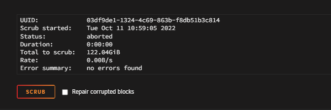

Thanks for the reply, I tried running the correcting scrub on the cache drive but it doesn't seem to do anything. When i click on apply the screen just flash but nothing happens. Not sure if I'm doing this incorrectly. Oh and by the way the issue with the ready only filesystem happened again this morning. Attached it the diagnostics from this morning.

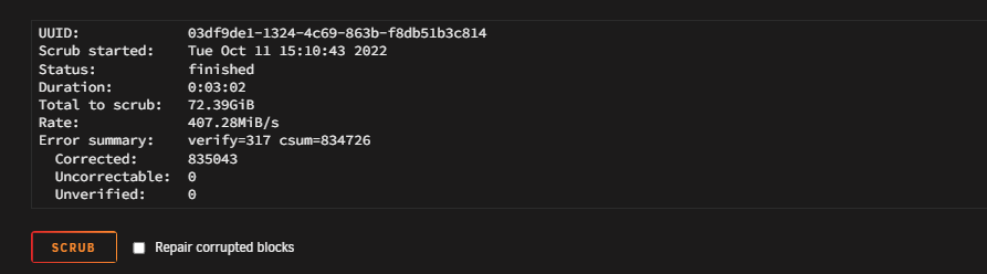

I checked cables and made sure they were seated properly. After booting back up, I was able to run the correcting scrub and here is the output and new diags.
plexserver-diagnostics-20221011-1956.zip
Looks good for now, see here for better pool motioning so you're notified if a device drops offline.
