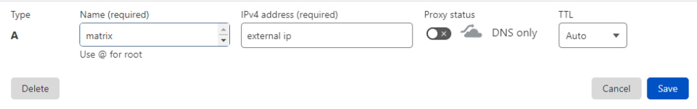

  • Create a A name record pointing at your external IP DNS only.

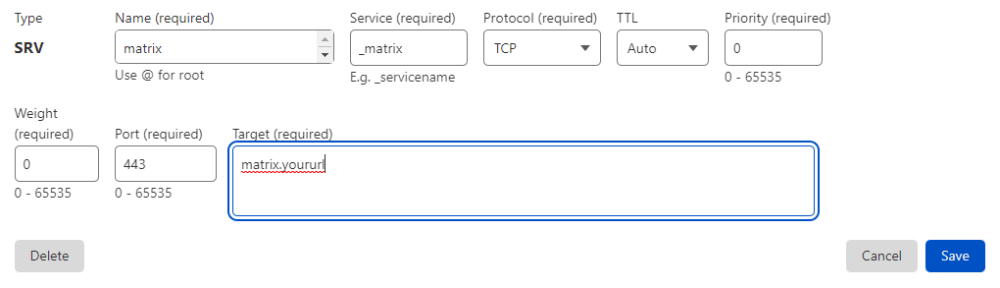

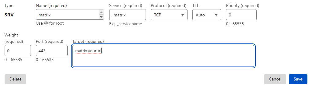

  • Create an SRV record _matrix targeted at your subdomain

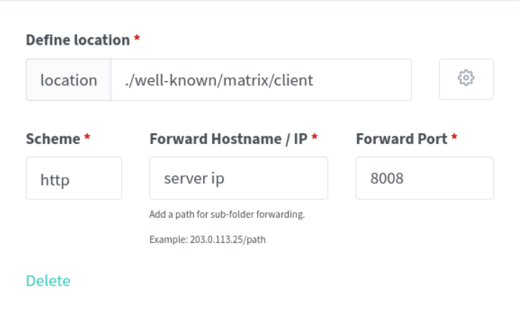

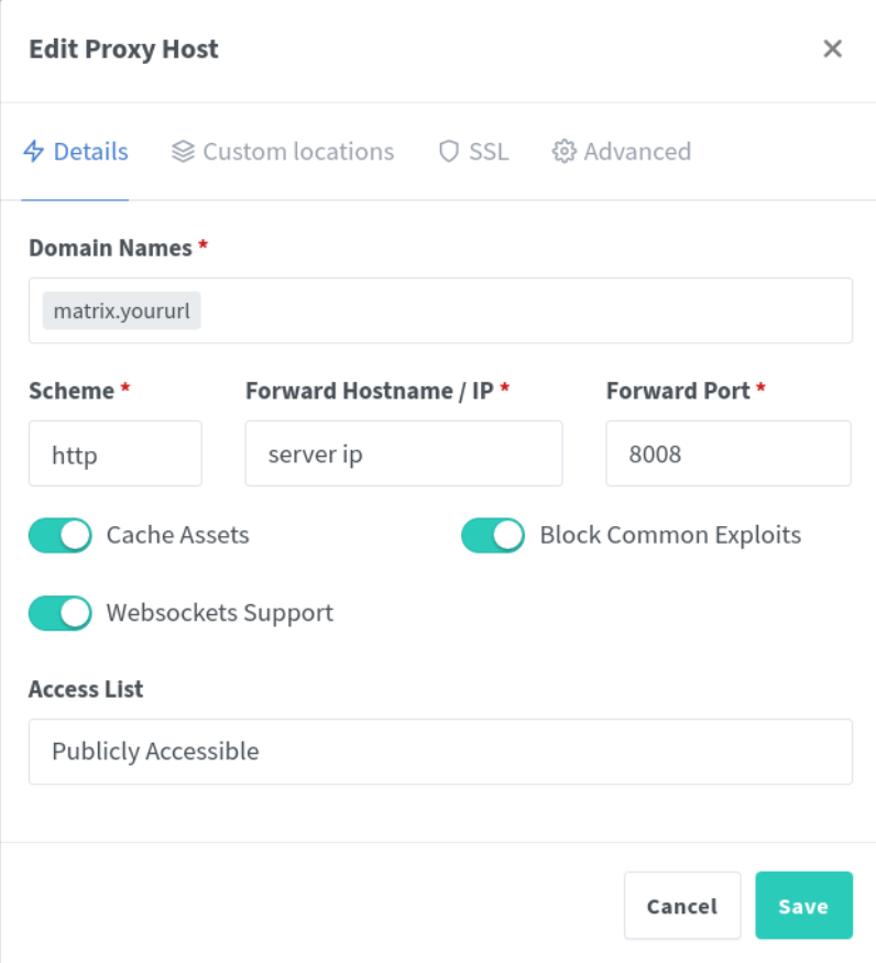

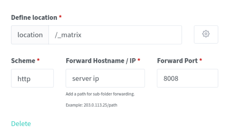

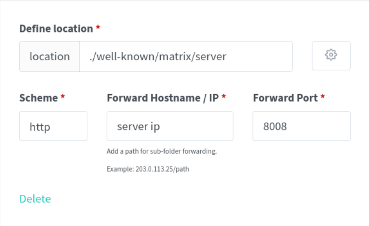

  • Nginx proxy manager
custom location Tap add 3

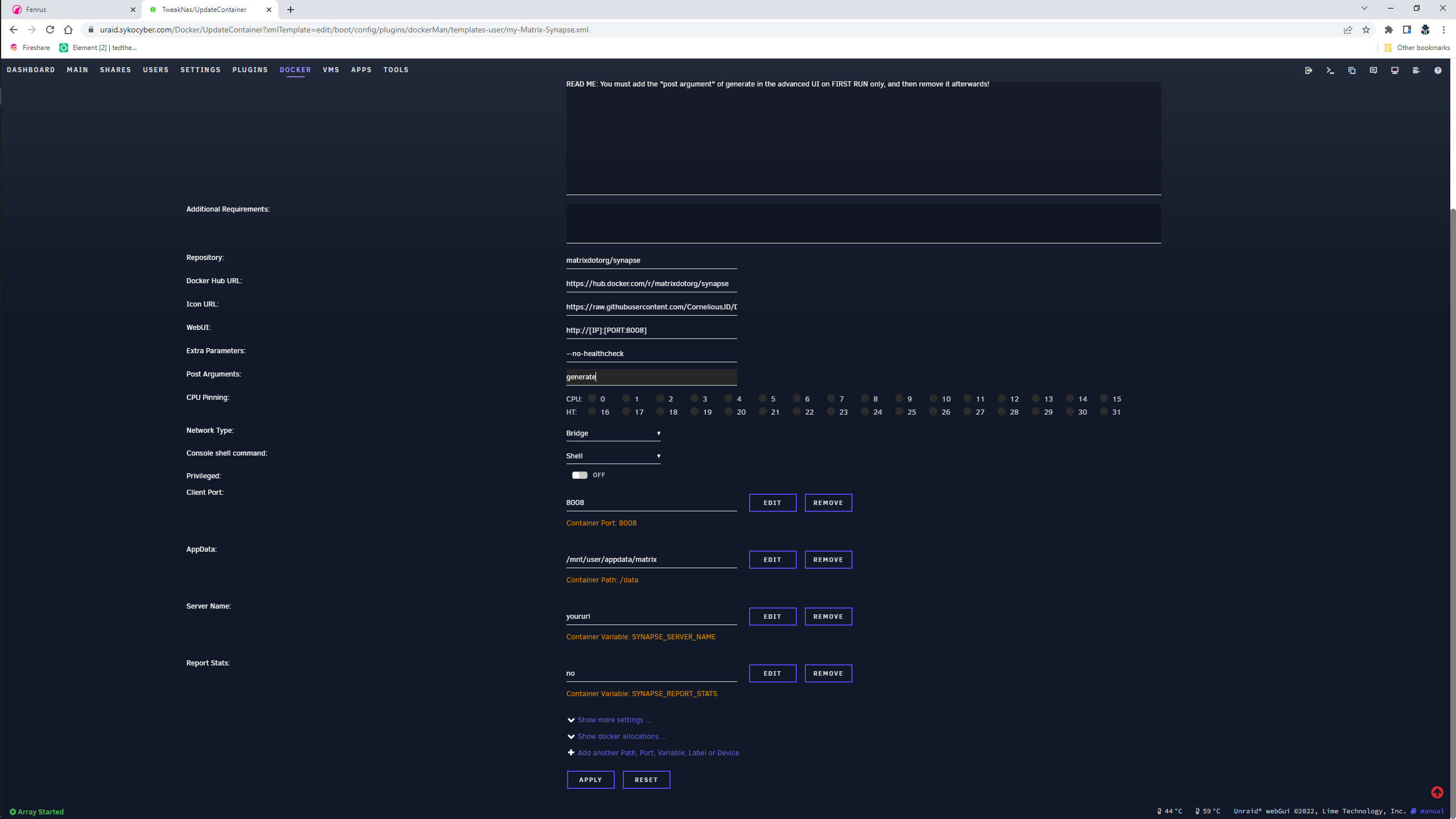

  • Matrix-Synapse Step two
Matrix-Synapse docker by matrixdotorg.
Delete all ports except Client Port 8008
add Server Name: matrix.yoururl
ADVANCED VIEW  Post Arguments: add generate
install the docker

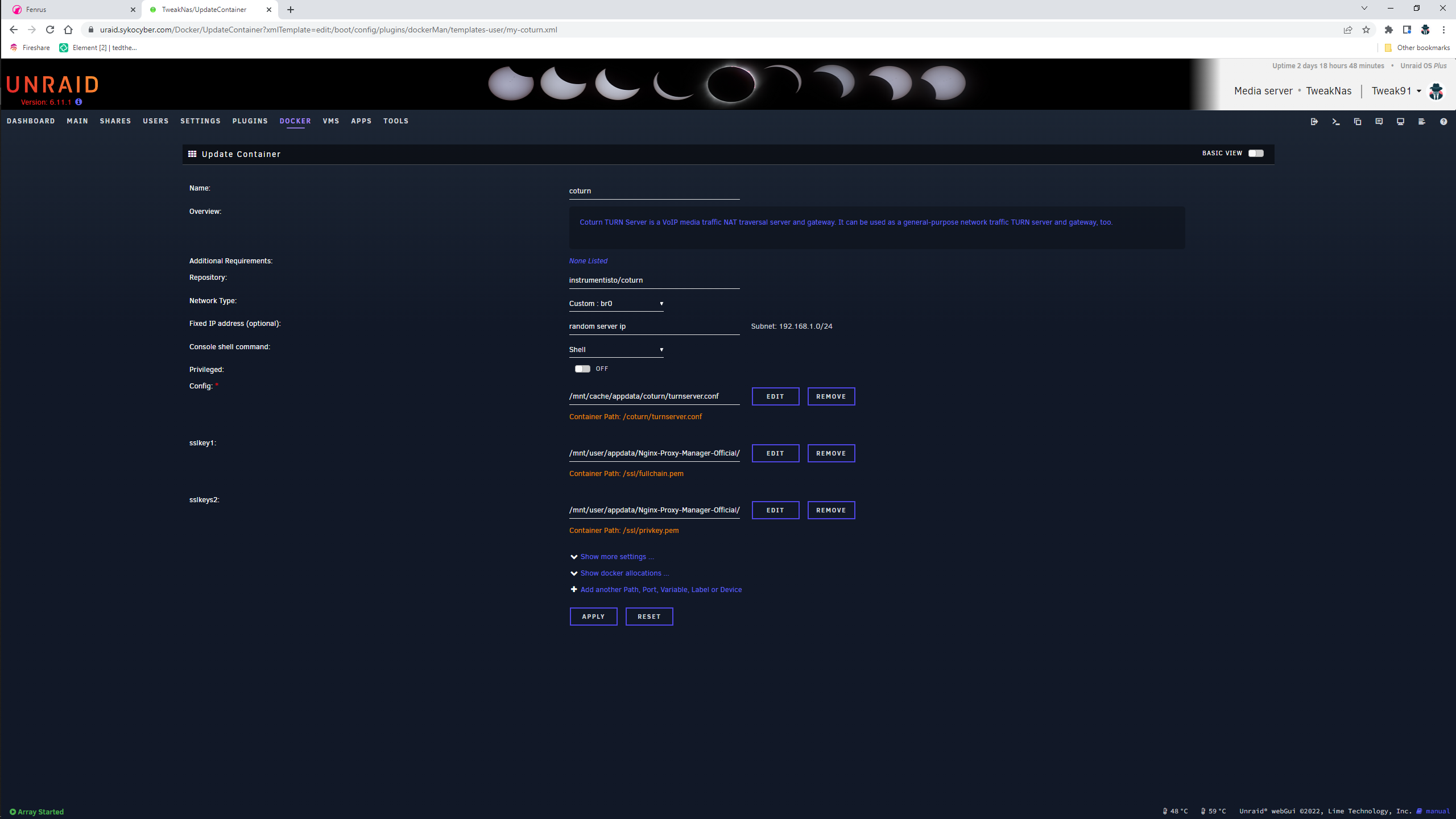

  • coturn Step four
change Network Type: too br0 use a open server IP
Delete all ports install

change turn.yoururl to your coturn url
change user=user:pass add the same user:pass created to homeserver.yaml
change cli password
port forwarding 49152- 65535 UDP

Make sure you delete generate from Post Arguments or it won't work.
