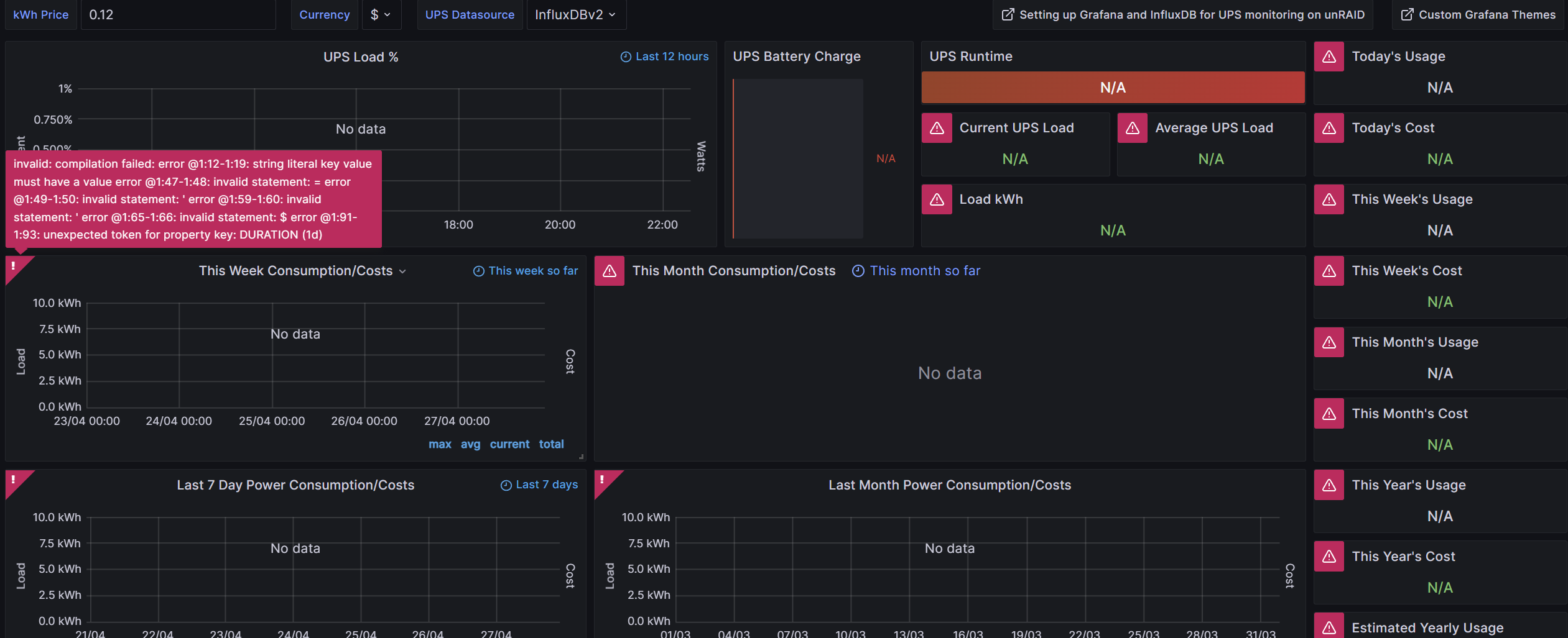

April 27, 20233 yr @jwillmer Thanks for exporter, all work fine but in grafana i have errors, it seems like dashboard for influxdbv1 ? not flux
April 27, 20233 yr Author 48 minutes ago, Masterwishx said: @jwillmer Thanks for exporter, all work fine but in grafana i have errors, it seems like dashboard for influxdbv1 ? not flux Thank you for the feedback. I have updated the Readme. Hope it works for you now.
April 27, 20233 yr Sorry its also not working becose im not using telegraf , i was thinking dashboard is getting values from influxDBv2 bucket.... but no problem i will try to build dashboard in flux from bucket when will have time ... most important the all NUT data goes to bucket by exporter
