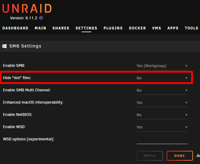

Solved by Kilrah
18 minutes ago, thany said:
Make it a "dotfile". The folder remains visible and navigable. They are not even marked as "hidden" for Windows clients.
That's a configurable setting,
Did the setting, now all my shares are gone, except for two which have gone "unprotected" and are now empty.
What the hecko?
Edit: nvm I gave it a good'ol magic reboot, and shares are back again. Phew.
Edit 2: anyway the setting worked a charm. I'm now able to set it up the way I wanted to. Thanks!
