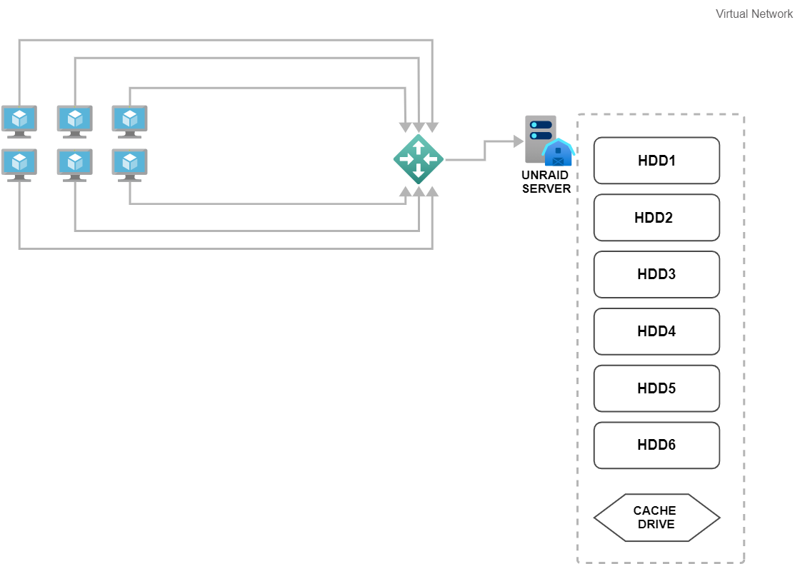

I am in the process of creating a mid ranged unraid server that has the capacity to host more than 10 hard drives ( i will buy UNRAID PRO License from the start ), the main purpose of this build is data storage for pictures and videos (server user is a professional photographer), initial budget is around 1700$ and hard drives  will be added quarterly, I new to servers and raids but not new to hardware and not afraid to get my hands dirty. initial build that I had in mind

Use case is like the below picture, each editor will be connected to the Unraid server via a switch we will have multiple pc accessing the server at a time and coping and writing data from the server.  312859942_myserver.thumb.png.00a53635352fe31cdfb9e2b0902583d4.png
