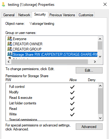

I've been recently testing the AD integration in Unraid and I can't seem to get just Modify permission to work on shares. Using the latest 6.11.2 release with the patches mentioned in the ongoing intermittent SMB issue thread it seems that anything permission using "Modify" results in having "Full Control" enabled instead.

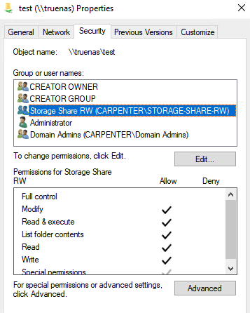

Initially joined using Administrator and Domain Admins for initial access. Simply adding a new AD group and selecting Modify and saving results in having Full Control always checked instead. I don't want users of this group to be able to make permission changes. Testing against a TrueNAS install seems to work appropriately.

Here's a screenshot of the TrueNAS test vm I spun up

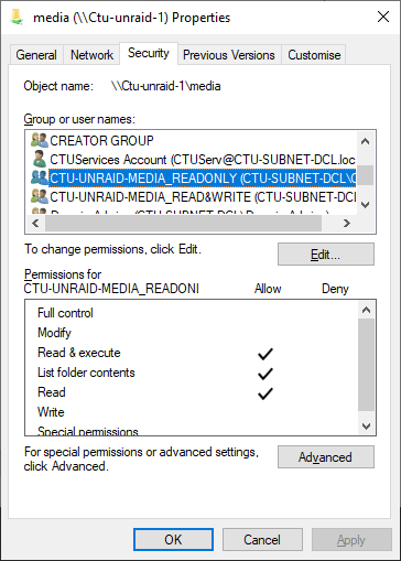

Mine seems to work as required in that sense, be sure to Click "Advance" and then "Replace all Child Objects......." then hit Apply.
Sometimes i have had Removed Security Groups such as "Domain Users" and "Everyone" re-appear after deletion though.
Hope that helps.
