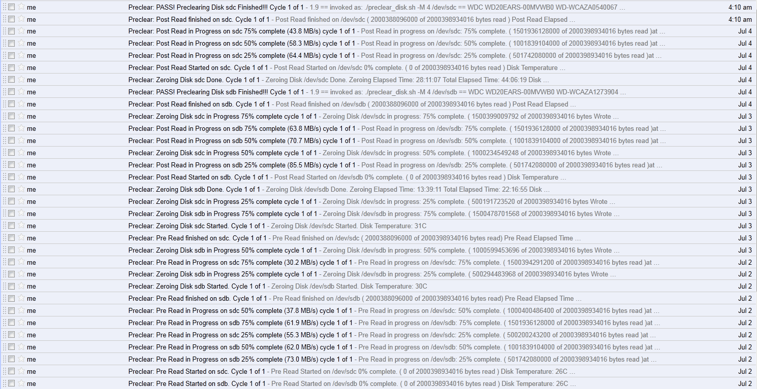

July 5, 201115 yr My setup is here (think ended up with a variant of this board because of a NIC compat issue): http://lime-technology.com/forum/index.php?topic=9644.0 I have had some read/write issues: http://lime-technology.com/forum/index.php?topic=12278.0 I brought it into work and hooked it up to an enterprise gig switch and was able to read 60-70mb and write at 10-15mbs. Got a different 1gig switch and took that home but haven't tried read/write tests yet. Instead, for continuity's sake I decided to preclear (...one...more...time). Mind you, these are the exact same drives and are both connected to the built in SATA on the board (haven't gotten the add-in cards yet... this is a slow process ): Drive 1: == Using :Read block size = 8225280 Bytes == Last Cycle's Pre Read Time : 8:37:43 (64 MB/s) == Last Cycle's Zeroing time : 13:39:11 (40 MB/s) == Last Cycle's Post Read Time : 15:33:42 (35 MB/s) == Last Cycle's Total Time : 37:51:44 == == Total Elapsed Time 37:51:44 == == Disk Start Temperature: 26C == == Current Disk Temperature: 32C, == ============================================================================ ** Changed attributes in files: /tmp/smart_start_sdb /tmp/smart_finish_sdb ATTRIBUTE NEW_VAL OLD_VAL FAILURE_THRESHOLD STATUS RAW_VALUE Seek_Error_Rate = 100 200 0 ok 0 Temperature_Celsius = 118 124 0 Drive 2: == Using :Read block size = 8225280 Bytes == Last Cycle's Pre Read Time : 15:55:11 (34 MB/s) == Last Cycle's Zeroing time : 28:11:07 (19 MB/s) == Last Cycle's Post Read Time : 21:09:27 (26 MB/s) == Last Cycle's Total Time : 65:16:53 == == Total Elapsed Time 65:16:53 == == Disk Start Temperature: 26C == == Current Disk Temperature: 32C, == ============================================================================ ** Changed attributes in files: /tmp/smart_start_sdc /tmp/smart_finish_sdc ATTRIBUTE NEW_VAL OLD_VAL FAILURE_THRESHOLD STATUS RAW_VALUE Raw_Read_Error_Rate = 197 195 51 ok 935 Temperature_Celsius = 118 124 0 ok 32 No SMART attributes are FAILING_NOW Attached is a screen shot from the SMTP shout-outs sent from the server, you can see the span of time and where they start at 'together' but then SDC starts to lag. I also attached the PASS emails for each drive as well. The other emails seemed insignificant other than then the one drive taking much, much, much longer. Anyone have any ideas why it might do this? If it was a resources issue I would think that SDC would kick it up a notch when SDB finished over a day earlier... if it was a cable or actual drive failure you would think that would show up in SMART in the preclear reports or just a general failure. unRaid and unMenu don't show any read/write errors, etc in any of the display screens that I could see. I do notice that the line Raw_Read_Error_Rate is much different on C than B, but both say 'ok' so I am not sure what that means... sdb_disk1.txt sdc_disk2.txt

July 6, 201115 yr Author Thanks cyrnel. I checked last night and the jumpers are off both drives. They were new when I installed them and the first thing I did back then was preclear them. One (presumably the same one) took longer than the other but I didn't pay too much attention. Is there something particular about the RAW_VALUE #?
July 6, 201115 yr Is there something particular about the RAW_VALUE #? Only meaningful to the manufacturer. We have no way to know what it represents. It is not the first time we've seen drives with drastically different performance. Are they on the same disk controller? Are they the same firmware version? (perhaps they made a fix in the newer firmware, or introduced a feature )
July 6, 201115 yr I had one WD 2TB green drive that took almost twice as long to complete a preclear cycle. I took it back and my dealer replaced it. There were some mentions here: http://lime-technology.com/forum/index.php?topic=12616.msg119971#msg119971 Stephen
July 6, 201115 yr From what little I know all drives these days use mad amounts of ECC so the only part of raw read errors that should be important (and are even intelligible) are the value and worst vs. threshold. Even with the other reports the difference in performance between the two drives is strange. It might be one of those proprietary things we'll never know, but if time allows you could exchange the drives (both position and cables) and test again. You could save time and probably get comparable numbers by simply running raw dd commands yourself, outside of preclear.sh.

July 31, 201115 yr Author Getting back to this thing... At this point I am about to toss those whole thing into the river - that's how frustrating this f*ing thing is becoming. Update: Got 4 WD 2tb EARS drives. One was pre-clearing very slow and registering some errors. I RMA'd that one and have the replacement in hand. Up until today I have only been running preclear on the built in SATA ports on the ASUS board. This is the M4A78LT-M and apparently is working in other setups for people. A couple days ago I tried preclearing two drives at once on the AOC-MV8-SASLP add-in card. They both started and I got the two confirmation emails that the next notice is at 25%, etc, etc. Hours and hours later when I didn't have any new emails I figured something was up. Connecting back up the the SCREEN sessions via Telnet didn't show anything - it's like they were stuck or something. The web interface was up but the syslog was last written to when I started preclear orginally... so anyway, I turned it off and came back to it today. Basically the same thing, same two drives on the same two drive bays - start preclear and then check back after a few hours. It's strange, the telnet/screen session barely updates (previously, it seemed like it was more 'responsive' with the %/time updating frequently. Now it seems to 'burst' update, a few minutes at a time...). ================================================================== 1.9 = unRAID server Pre-Clear disk /dev/sdb = cycle 1 of 1, partition start on sector 64 = Disk Pre-Read in progress: 1% complete = ( 31,256,064,000 bytes of 2,000,398,934,016 read ) 31.5 MB/s = = = = = = = = = = Disk Temperature: 30C, Elapsed Time: 0:15:54 I attached the syslog at the point from boot --> start of preclear on one (1) disk on the SuperMicro card (first SATA port). A few things: Why is this such a PITA? I know other folks have better luck with this than me, but frankly, I am not even sure if I would trust this if I got it going. This is all new gear, vetted from the list of stuff that is supposed to work together compiled for studying other examples on this site. So damn frustrating. Even though it is SUPPOSED to work does the Super Micro AOC-MV8-SASLP card really not work that well in 4.7??: http://lime-technology.com/forum/index.php?topic=10618.0 The above post ends with someone more or less saying, 'doesn't work for me either'. Should I RAM yet another thing and send back the SuperMicro card??? I went into the BIOS for the card itself, not much you can change. Mode is JBOD, didn't see where I could change anything of substance (had some spin up delays, etc). Any ideas before i just part this thing out or go a different direction??? syslog.pdf
