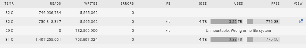

I juste started to use unraid (instead of freenas) great system :). I don't understand why one of my disk is Unmountable.
The disk have been added to the array and cleaned and the issue appeared after the first rebuild of the array.
To fix the issue i've stop the array, removed the disk, restart the array and re-added the disk but the issue stayed even after the seconde rebuild :(
I don't know how to fix this. To be clear there is no data on the disk.
Solved by trurl
If there is no data on that particular disk you can just format it in Main-Array Operations
As simple as that, it work :)
Thanks a lot
