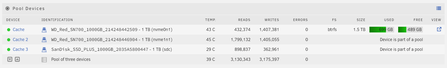

Yeah no console access unfortunately. I have rebooted the server and a parity check has just started. I don't see anything about a BTRFS operation, how do i know if it ran successfully? I do see my cache pool with my two new drives and one old SSD, all three of those devices say "normal operation, device is active". But i'm also getting a "Warning - pool BTRFS too many profiles (You can ignore this warning when a pool balance operation is in progress)" message while there's no new BTRFS action starting at the moment, just the parity check.
How do i know if the previous BTRFS operation finished or not? Do i need to somehow start a balance operation manually (seeing this warning)? And do i need to wait for the parity check to finish first?

And it said 9% left. I just ran it again and it says "No balance found" so i assume that means it's done? So i think i'll wait for the parity check to complete and then remove the old SSD from the cache pool.
Only thing i'm confused about: Why does my cache say "size: 1.5TB" with 3x1TB drives and the "used" and "free" numbers add up to 1.09TB? Is this normal?

It's a known btrfs issue with and odd number of devices in a pool.
