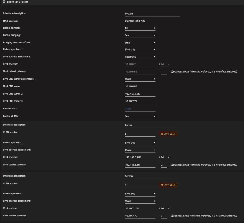

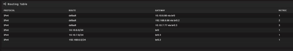

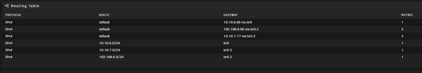

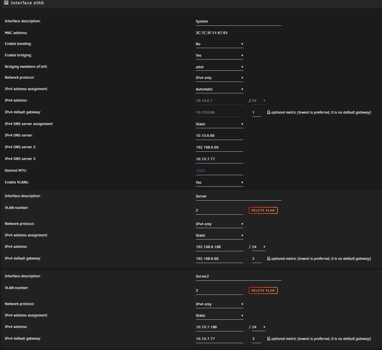

I'm a networking noob and I really need help.   I have 3 routers, and I want to be able to talk to all three of them but my NAS box only has one ethernet port.  I added two VLANs in the network settings but I can only ping the primary router on br0, br0.2 and br0.3 routers are not pingable.  Can someone take a look at my network settings and give me some advice.

To gain access to the other lans, you do not have to do anything in UNRAID, delete those VLANs and you are done.
You say the lans are physically connected, but are they also are logically connected? Just plugging all of them into the same switch does nothing (just producing a bit of chaos).
Alternative 1:
What you need is to add specific routes into the gateways.
G1 needs to know how to reach G2 and vice versa.
This usually implies to give them a 2nd address from the other net and add a manual manual route into the routing table of the router (thus overwriting the default route for this lan)
Alternative 2:
OR you can tell your switch to use VLANs, #1 for the port of Gateway1, #2 for G2 and #3 for G3. And you put the UNRAID port into #1+#2+#3.
You can keep your current VLANs then, but you have to delete the default Gateway on the settings #2 and #3.
UNRAID will then talk to the outside world on G1, but sends out packets to the LAN addresses to 2 & 3 tagged with the appropriate VLAN ID.
(It is up to the switch to deliver them to the correct ports)
First of all you have to check if your switch is capable of handling VLANs at all ("unmanaged" one surely are not, for "managed" ones look into the manual, normally they can handle it)
Without switch support nothing will work.
There are more possible alternatives for this situations, but they usually need additinal hardware like a Layer-3 Switch/Router. This would be an overkill for such few devices I fear.
