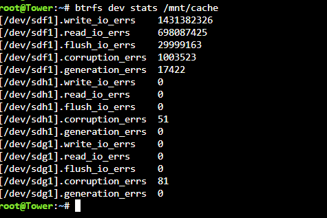

Thanks for the reply.  I tried running the stats command on my cache pool and had the following results:
Looks like I do certainly have some integrity issues.  When I try to go to the GUI to run the scrub command, the page just keeps flashing and I can't click anything.  Not sure if that's related to my current issue or if its a bug.  No other drives do this.  I suppose I could run the scrub command from the CLI, I'll see if I can find the proper commands so that I don't accidentally delete my file system.
Strange, I tried to run the scrub from a different browser (Edge) and I can access the GUI page of the cache drive without issues.  Not sure why that flickering is happening with Chrome and only on the cache drive gui but oh well. I have the scrub running now.  In the meantime, if it finds uncorrectable errors, what should my next steps be?
If there are uncorrectable errors the affected files will be listed in the syslog, then delete/restore from backup.
