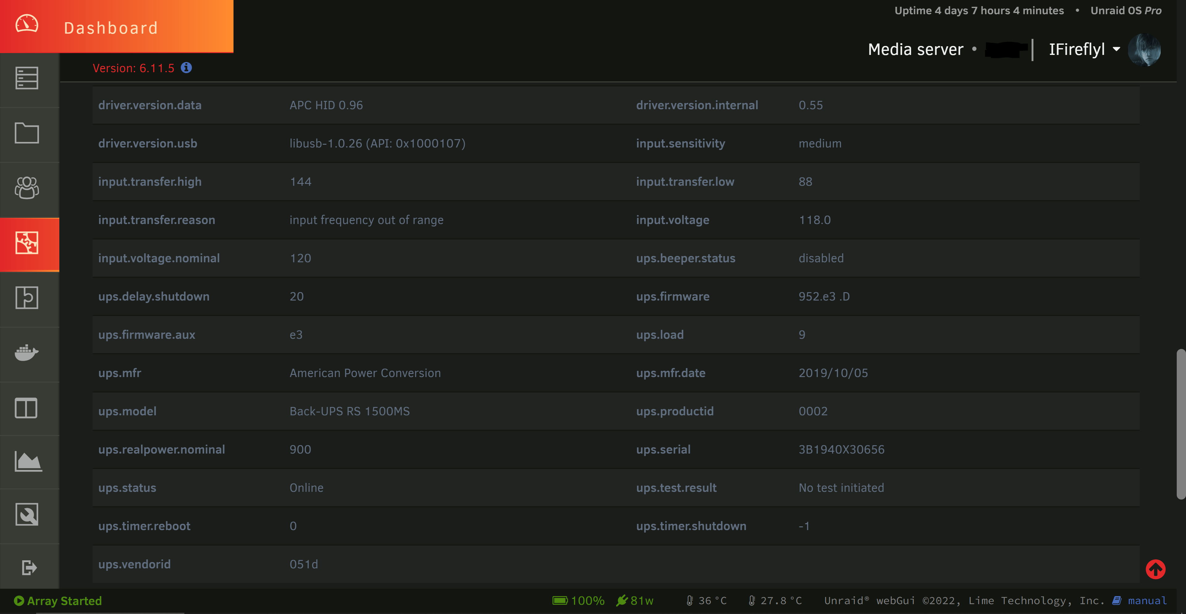

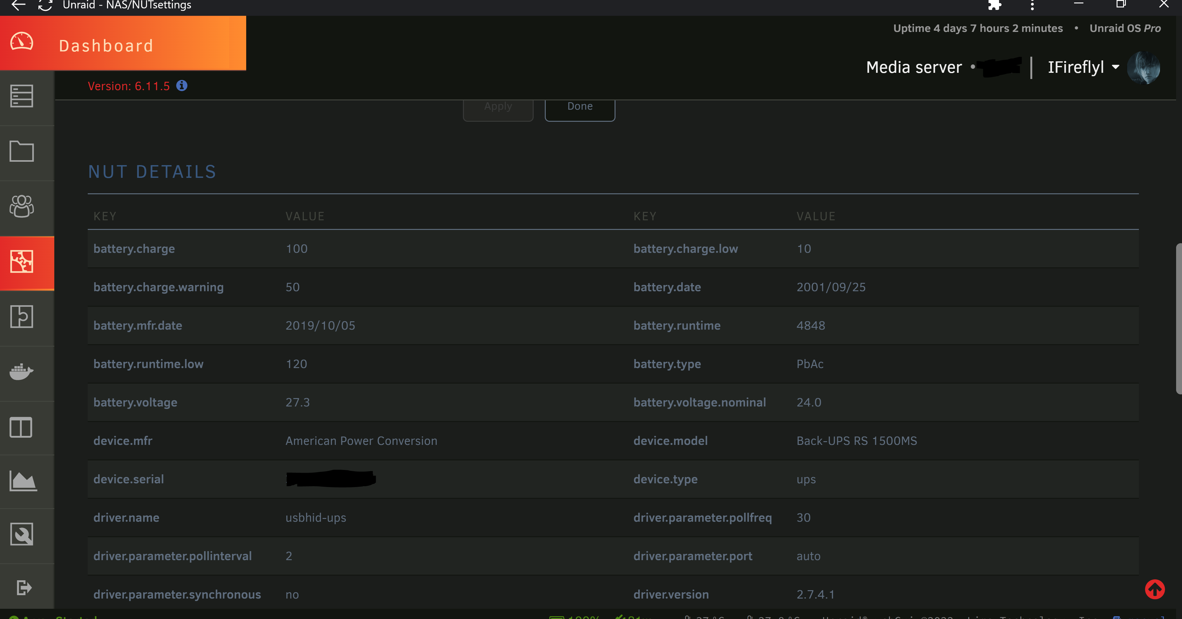

I went with this behemoth:
https://www.amazon.com/APC-Protector-BR1500MS2-Back-UPS-Uninterruptible/dp/B08GRY1W93/
That's probably way overkill for most people (myself included). That particular model comes with a cable that you plug into the back of the UPS, and then you plug the other end into a USB-A port on your Unraid server. Unraid has a built in UPS manager that is found in Settings > UPS Settings. Having said that, I downloaded Network UPS Tool (NUT) from the Community Apps to use that as my UPS manager instead of Unraid.
You can edit the shutdown settings to do a clean shutdown of your Unraid server after X amount of time on battery, after the battery has less than X% of charge remaining, or as soon as the power goes out. I would always recommend using battery percentage over amount of time on battery though. Batteries have diminishing returns over time, and you don't want to say, "Let's have this on battery for X minutes because I know that works," and then one time you find out that the X minutes was longer than your UPS could hold a charge. That would result in an unclean shutdown, and that could lead to potential data loss.
