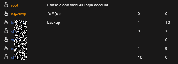

Suddenly nearly all Users gone after Shutdown
A wonderful good day my friends,
Yesterday I briefly shut down the Unraid server and unscrewed the feet on the housing.
When I booted the system up again, no network share was functional anywhere.
Then I saw this on the Dashboard:
Even after several reboots, the appropriate users no longer appeared.
I was able to recreate all users again.
The Unraid still knew all permissions of the other users..

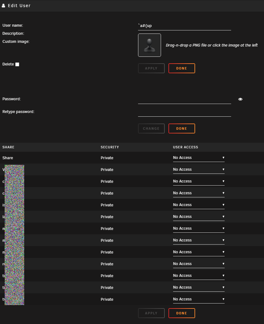

Sadly, I can no longer delete this weirdo. I have changed his permissions. Had access on my "share"-share, which was set in public...
Now to the question:
1. how could I find out what happened?
2. is it possible to delete users created in Unraid via CLI?
Thanks in advance and have a good start into the new year.
Nothing obvious that I can see, if you go to /boot/config/shares do you see that garbled backup share cfg?
Do you have a recent flash drive backup?
The last backup is a bit older, sadly. :|

Root is and was working.
Recreated the users already.
Cant delete the weird user in picture 4.
When i hit delete nothings happens.
Therefore the question, if you could delete an Unraid-User through CLI.
Deleting those files will delete all the users, technically you only need to delete one, but not sure which one stores the users, I believe it's config/passwd if you want to try just that one.
Iam still not talking about files.
A User, that randomly - out of nothing - appeared.
Which sadly cant be removed through the Users Tab within Unraid.
So it is not possible to delete a Unraid User other the with Unraid it self?
Again, if you delete those files it should delete all the users.
