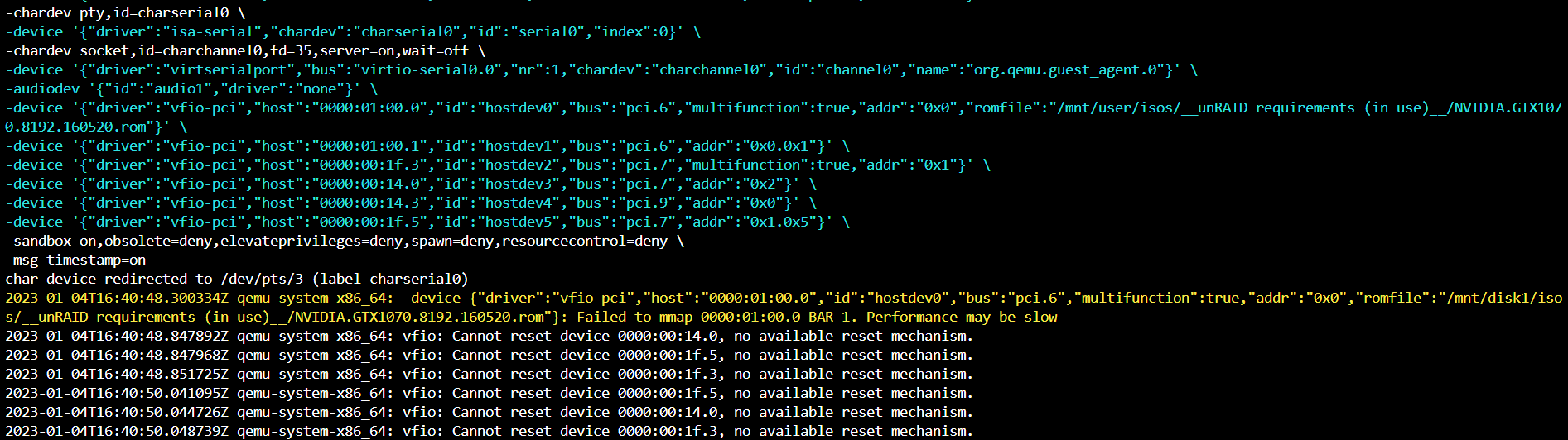

I recently created a second VM for gaming. After tweaking it, I shut down and attempted to return to my main windows vm. Here's the vm log:
I'm experiencing a black screen. I've attempted to perform a hard reboot to no avail. After a while, I edited the VM to use VNC instead of my GPU. Started the vm (which failed), then rolled back to using my gpu. I rebooted the vm via gui. My OS finally appeared to boot successfully, but with terrible stutters (below 40fps). I performed a reboot from that windows vm, and now I'm stuck back where I started (black screen). Do I need to start fresh with a clean vm?
Have you totally powered off at any point in testing? Sometimes video cards get stuck if they don't get a proper power cycle. Sometimes loading the video BIOS as part of the VM startup can help, sometimes not.
Yes. I typically shut down and hold the power button while unplugged to make sure im getting a completely fresh reboot.
