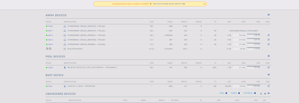

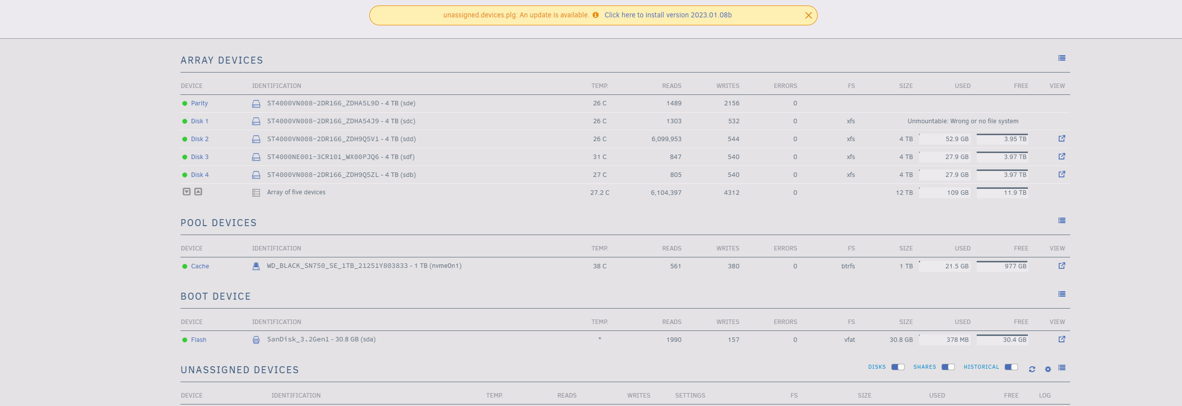

Disk1 was already unmountable when it booted, no way to know what might have caused it. No obvious I/O errors in syslog (yet).
Other than that your configuration looks good.

Start the array in normal (not Maintenance) mode and post new diagnostics.
Looks good. Nothing even got lost+found. This was an easy one
