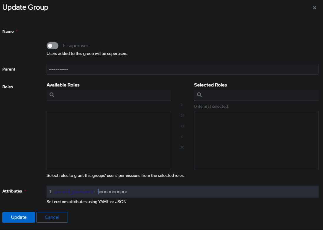

Created a new group with the attribute
unraid_password: xxxxxxx
being the password used for the root account, assigned this to my normal Authentik account I use.

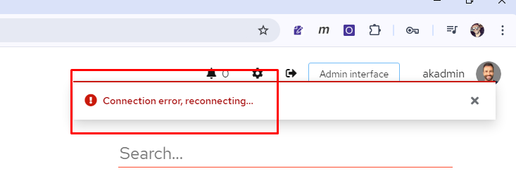

Hi guys...I installed Authentik today...even though I'm connected, this message appears. Any suggestions?
Are you running through a reverse proxy?
If so make sure you’ve got websocket support enabled/setup properly.
