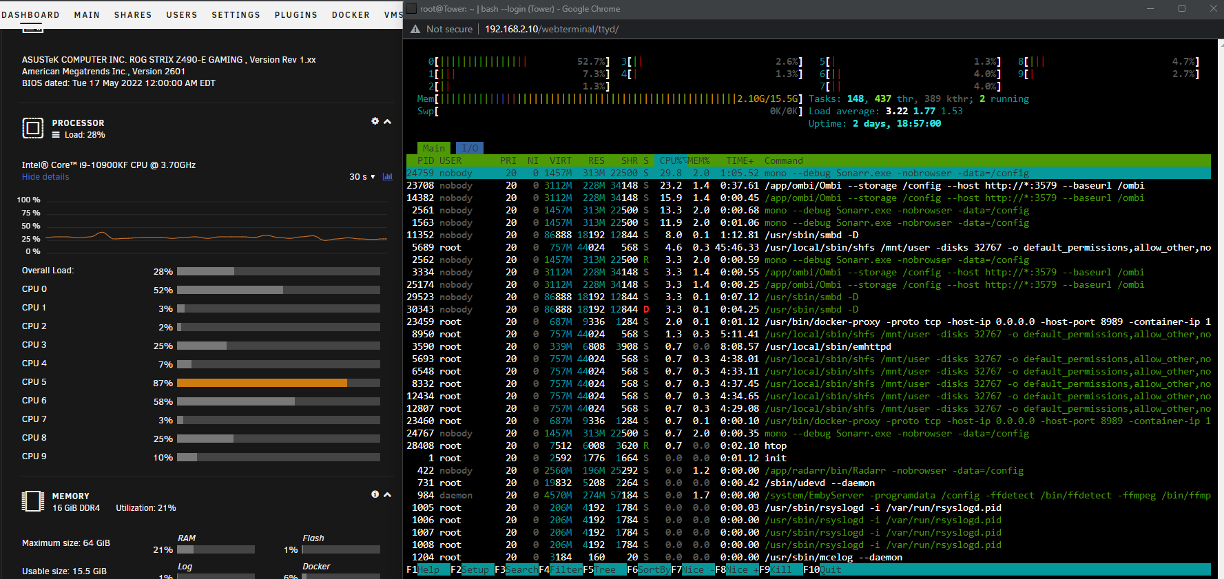

Yeah this doesn't add up at all.   If I stop the transfer everything goes to normal.   Here is a screenshot during a file transfer.
CPU usage on htop looks normal, some usage is expected, dash looks exaggerated because of the i/o wait, has for what's causing the problem northing jumps out in the diags, though it's been known to happens to some, if you connect two devices to the onboard SATA and transfer from one to another do you see the same?

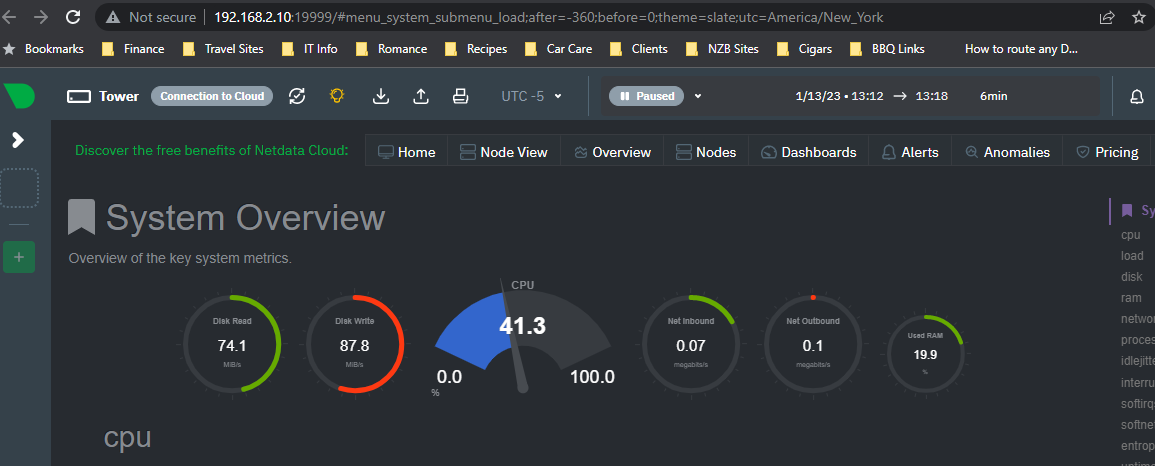

I installed NetData and as you can see my CPU is spiking during a file transfer.   Why would the CPU be touched for data movement?
I haven't done this yet but not a bad idea.   Maybe this weekend I will try this out and see what happens.  Thanks for you input and help.
