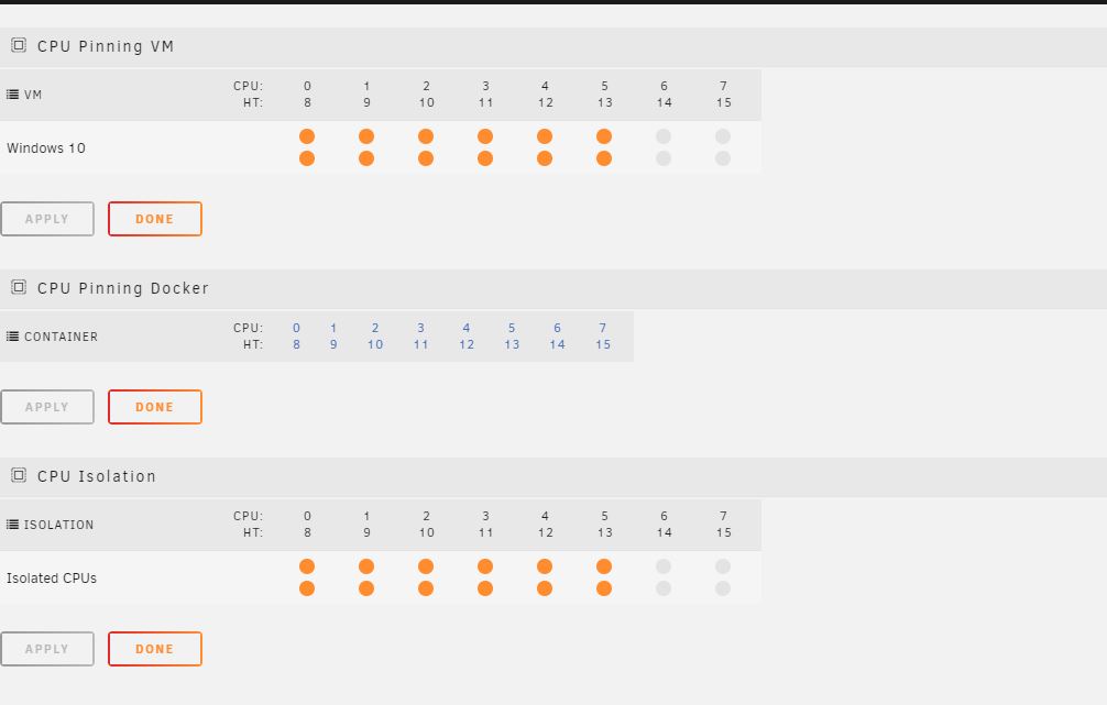

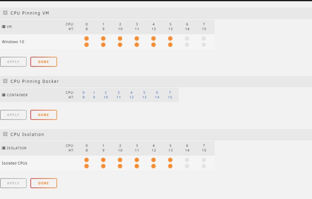

My issues are that the VM seems sluggish compared to Win10 on bare hardware. Several cores, and 16G RAM is allocated. Also, I am unable to set a 'Custom Resolution' via Nivida Control Panel.

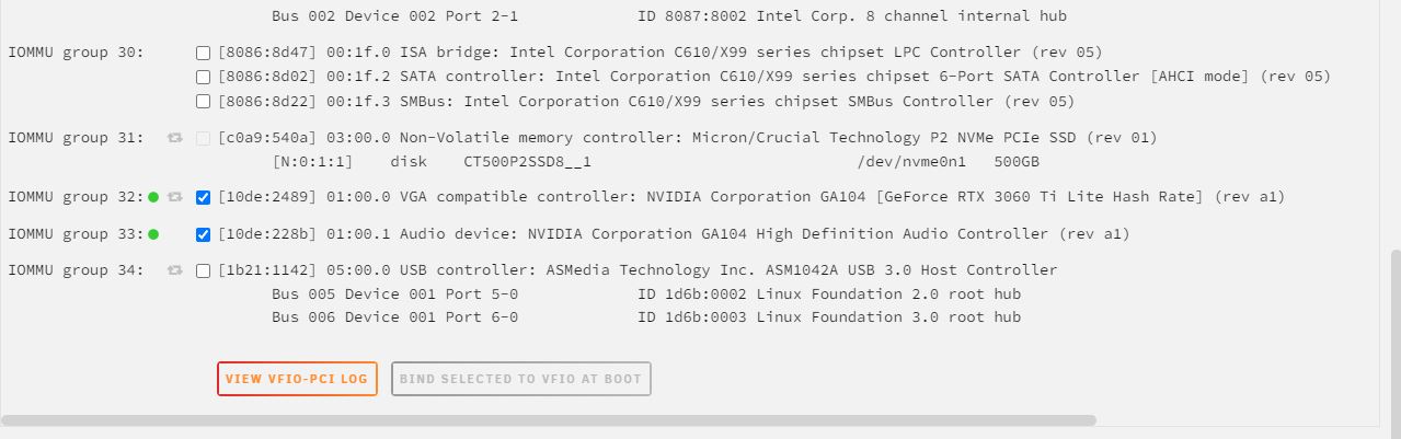

I have VT-D enabled in BIOS, and HDMI dongle plugged into the card, VM installed on NVME drive and all the following settings applied.
Any help would be appreciated.

  <vcpu placement='static'>12</vcpu>
  <cputune>
    <vcpupin vcpu='0' cpuset='0'/>
    <vcpupin vcpu='1' cpuset='8'/>
    <vcpupin vcpu='2' cpuset='1'/>
    <vcpupin vcpu='3' cpuset='9'/>
    <vcpupin vcpu='4' cpuset='2'/>
    <vcpupin vcpu='5' cpuset='10'/>
    <vcpupin vcpu='6' cpuset='3'/>
    <vcpupin vcpu='7' cpuset='11'/>
    <vcpupin vcpu='8' cpuset='4'/>
    <vcpupin vcpu='9' cpuset='12'/>
    <vcpupin vcpu='10' cpuset='5'/>
    <vcpupin vcpu='11' cpuset='13'/>

  append vfio-pci.ids=10de:2489,10de:228b initrd=/bzroot video=efifb:off acpi_enforce_resources=lax isolcpus=0-5,8-13 pcie_acs_override=downstream,multifunction
