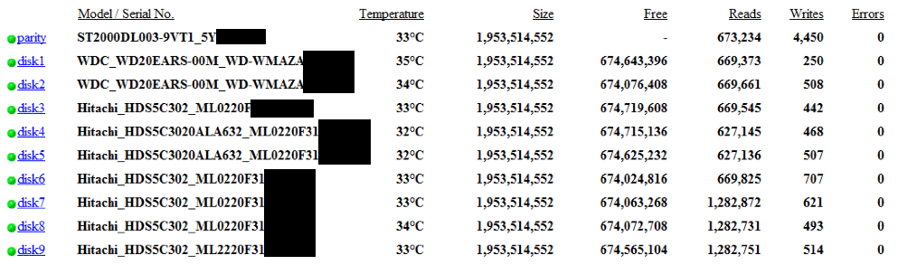

Hi all,
Please see the attached image. Disks parity - Disk6 are on motherboard SATA connections, Disk7 - Disk9 are on a AOC-SASLP-MV8. Does anyone know why the AOC-SASLP-MV8 would be causing double reads on those drives? Parity checks take upwards of 24 hours as well.
Any help would be greatly appreciated.
Ben

probably because the buffer size used by the driver for the AOC-SASLP-MV8 is half the size of that used by the driver for the chipset on the motheboard.  It therefore needs to read two "buffers" worth to access the same amount of data as the other disk controller gets in a single read.

So you are saying:
1byte read operation = 1 read = 2byte read operation
as opposed to
1byte read = 1 read
2bytes read = 2 reads
Thanks for the help. Can I infer from your response that this means that it's normal?
Thanks,
Ben
So you are saying:
as opposed to
1byte read = 1 read
In other words:
With a 1 byte buffer
  1byte read = 1 read operation
  2bytes read = 2 read operations
  3bytes read = 3 read operations
  4bytes read = 4 read operations
With a 2 byte buffer
  2bytes read = 1 read operation
  3bytes read = 2 read operations
  4bytes read = 2 read operations
yes, and one probably has a 512 byte buffer and the other has a 1024 byte buffer.
(or one 1024 and the other 2048, or something like that)
Right ... so those numbers are counts of read operations/events/requests/whatever, not bytes read.  I always wondered that, now I know :)  Now back on topic :)
