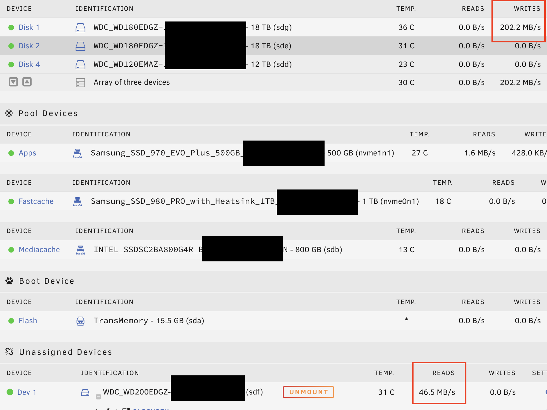

Out of curiosity, I noted the file that was currently being copied to my array at around 16MB/s. I opened up Krusader and did a couple of test copies.
I copied that exact same file and simultaneously pasted it to the share mount. This successfully copied at a transfer rate ranging between 60-75MB/s. The resulting file ended up being stored on disk1, which is where everything else has gone so far.
I then pasted the same file directly to disk1, thinking that this would go faster. This crawled along at 16-19MB/s.
What am I missing? I know not to expect rapid transfer speeds with Unraid, but surely this isn't normal? For comparison, I copied all 17TB of my media to that single HDD in just under 26 hours (in a virtualised setup!). This new setup hasn't even done 8TB after 40 hours.
Also, why would I see these read and write speeds on the dashboard but not have this reflect in my file transfers? It's like there's a cache bottleneck somewhere that I'm missing.

So I tried with MC, and in summary, large transfers of data through FUSE can replicate this slow down.
Disk share to disk share HDD transfers run at full speed with no issues. I transferred my remaining ~9TB of data in timeframe one would expect from a fully performant drive.
Another thing I noticed is that NVME to NVME transfers cap out at 1.1GB/s, even using disk mounts. Considering I'm running NVME's capable of R/W speeds over 3,000+, this seems poor. This will max a 10gbe NIC, so it's not the end of the world, but it would be nice to know that my drives are performing to the best of their capabilities internally.
