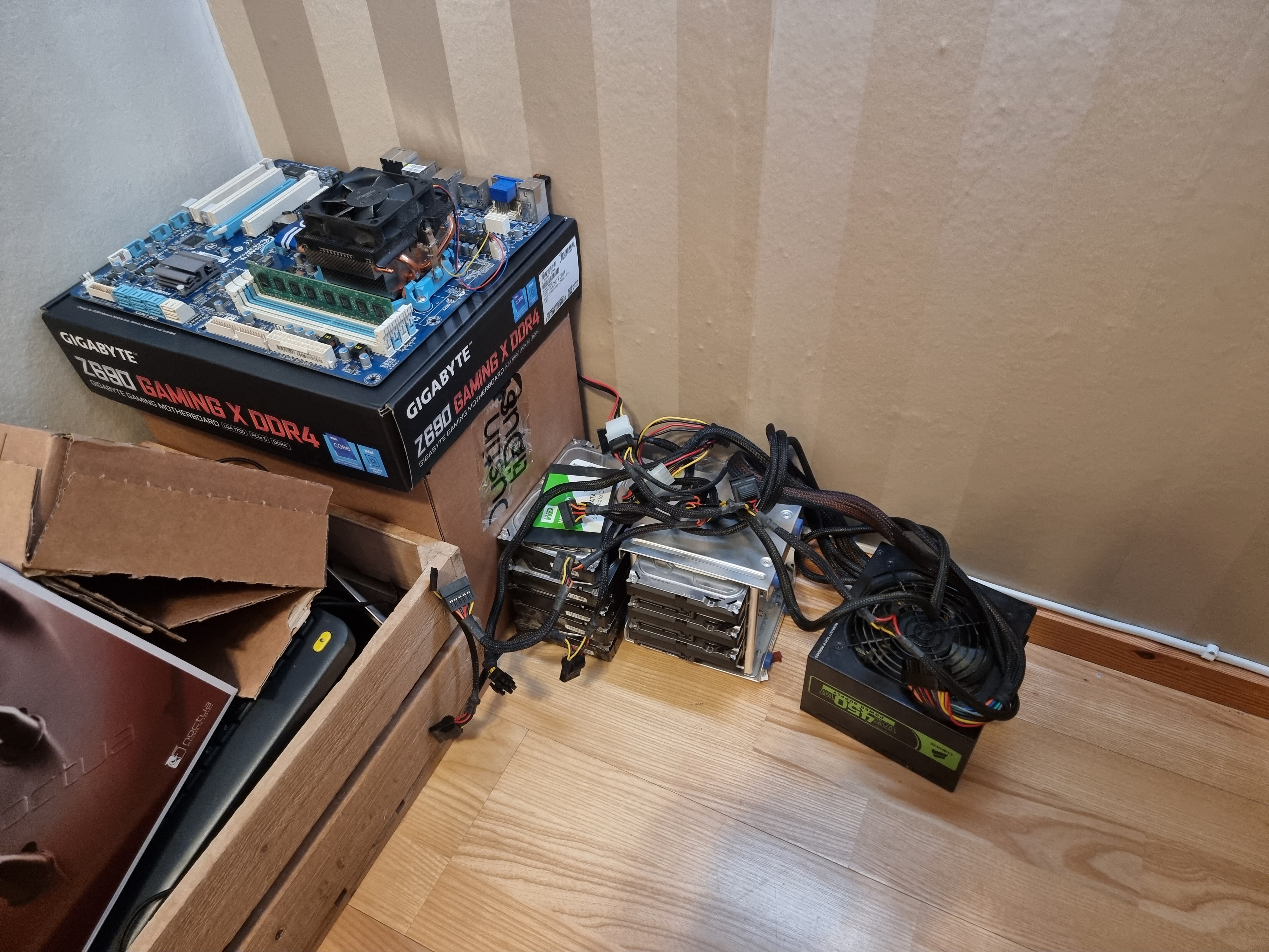

Ordered a new server to run Unraid. As I went for overkill specs I could only afford one HDD - a Seagate EXOS 20TB. I'll buy more in a few weeks for more storage and parity.
Sadly the Exos was DOA. I'm an impatient person, so I threw in 6 old 2TB's from a previous Linux software raid setup. This was a AMD Phenom II 955 and 4GB of RAM.
The drives have been powered on from around 60 to 70k hours. A few throws out a few SMART errors, but nothing critical.
My replacement Exos 20TB arrives tomorrow, so I'm a bit torn with what to do with the old hardware and drives. I don't want to run these old drives in my main array. When can we have multiple arrays with parity, pls? :D
Taking idea for what do with them, but I'm considering to move the drives back in my old server, and run Unraid on it. I have a total of 8 2TB drives I can deploy. 14TB of pure storage is dumb to throw in a closet, even if the drives are old. As a straight smb/backup/fileserver, I assume the specs are good enough.
I would like to keep my current USB drive/config for the main server though.
If I move these drives back to my old hardware, can I just add the drives in the same order to a new array, and the data will be there - or do I need some config files from the current USB drive?

I ended up retiring the old server. Simply couldnt justify the power usage from 8 2TB drives I don't really trust with any important data.
Decided to set up rclone with mergerfs on my main server instead and it suits my needs beautifully.
Rest in peace ye old faithful
