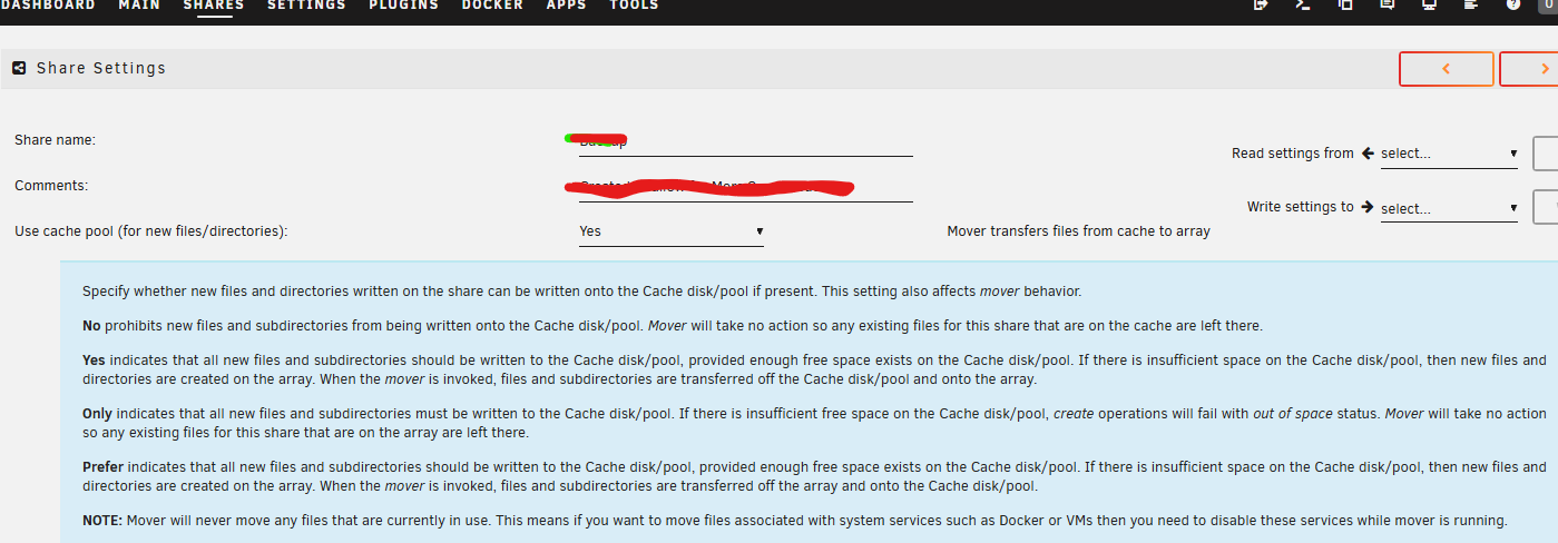

I tried lot of configs and it not seems to work as I would. The cache still keep the files, and then they are copied in the array. But not in the USB Key as I configured it (in the isos share, i told it to only use Disk5, and not use the others). I continue to test other config.

Have you found this setting?
