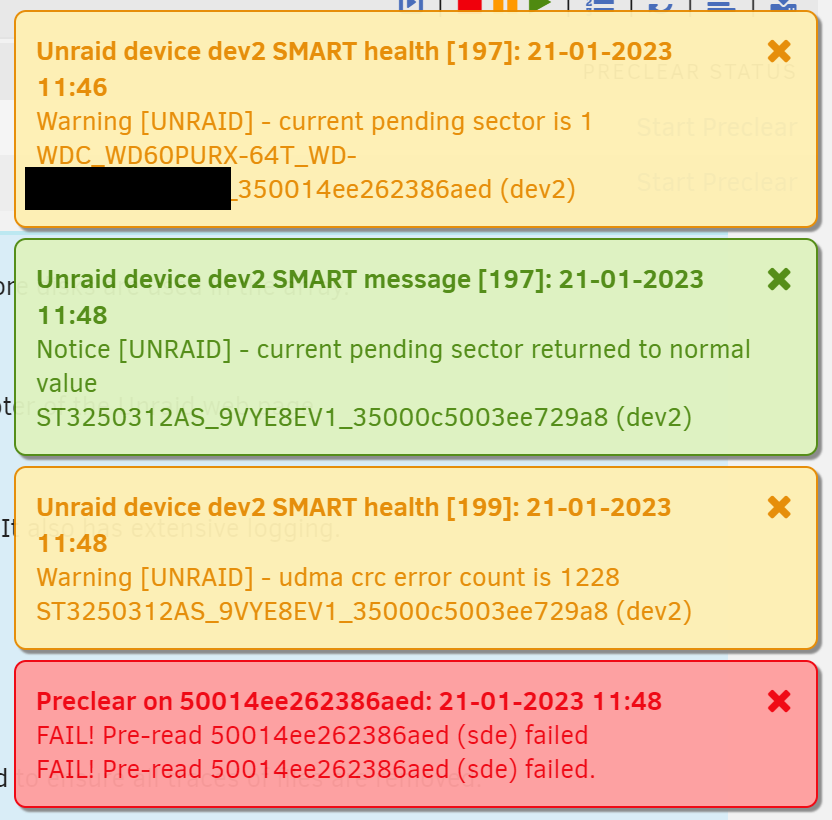

It arrived today, so I plugged it in and started to preclear it again for my own peace of mind and very quickly it flagged pending sectors and for the first time a complete FAIL warning - also another disk which happened to be installed at the same time flagged up a SMART error then cleared;
So I began thinking that this seemed to be too much of a coincidence to have so many failed disks and the common denominator is the machine I am using to test them. So, tonight I booted UnRAID on a standard desktop PC with just the replacement 6Tb disk in and as I write this it is showing a throughput of 180Mb/s and is 7% through its pre-read with no errors (so far).
So, the first thing I can imagine is that there is a power issue or a problem with the P420i RAID card. I have a spare P420i, which I will swap out next week to see if the disk is showing as clear during a preclear run... but on the PSU there is a switch which enables the 12v supply to be run as a single 12v rail or multiple 12v rail mode. Corsirs explanation is;
