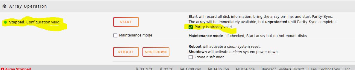

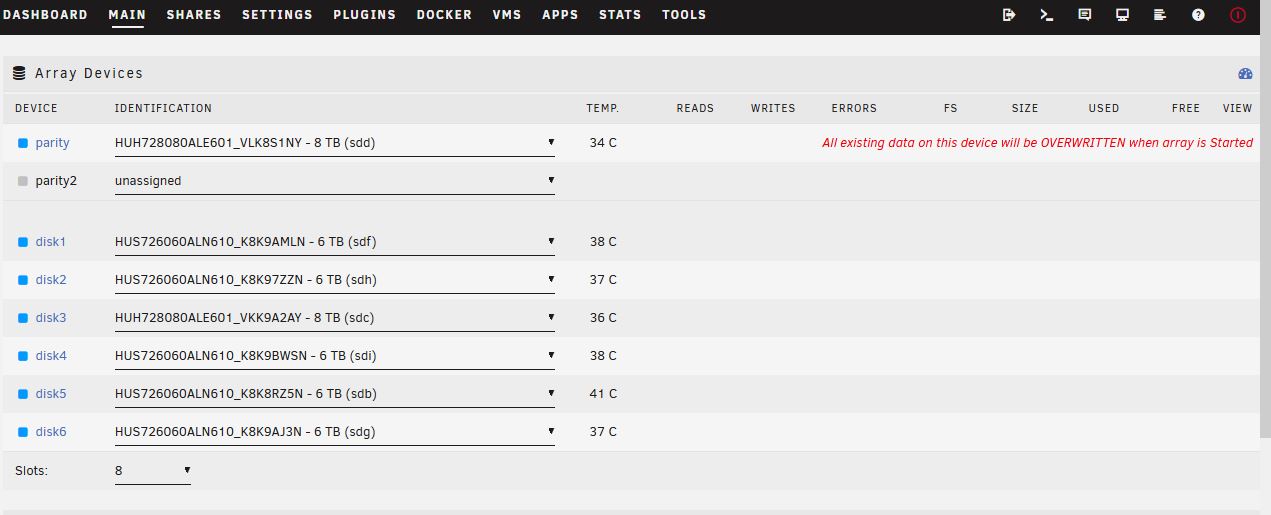

Maybe just a nervous Nellie, but after New Config (Array) I still had nothing assigned in MAIN array slots.  I have addedthe drives back to their original slots, and have checked "Parity is already valid".  Put the "All existing data on this device will be OVERWRITTEN when array is Started" message is still a bit concerning.
I am all set to start the array, correct?
correct
Thank you  sir!  I look to be back on the road to recovery.  Thank you so much for holding my hand through this.  I've read too many threads in this forum where people blindly move forward without knowing for sure what they do is correct.  I didn't wish to be one of them.
