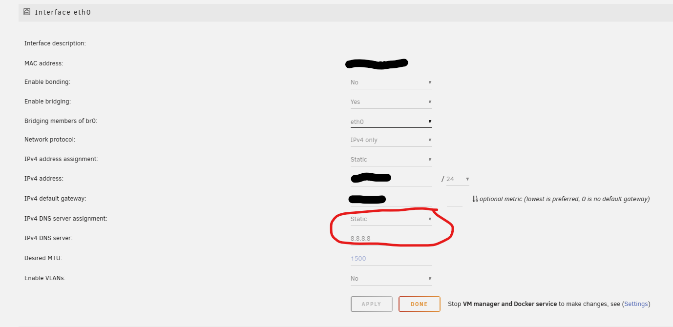

Go to Settings -> Network Settings and remove any static DNS server that might be set. Replace it with 8.8.8.8
I updated it but still no love. Did I do this correctly?

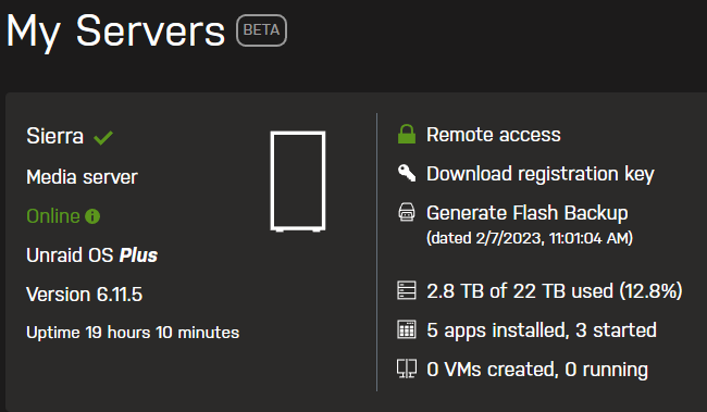

Remote access is green now, but still can't access.
