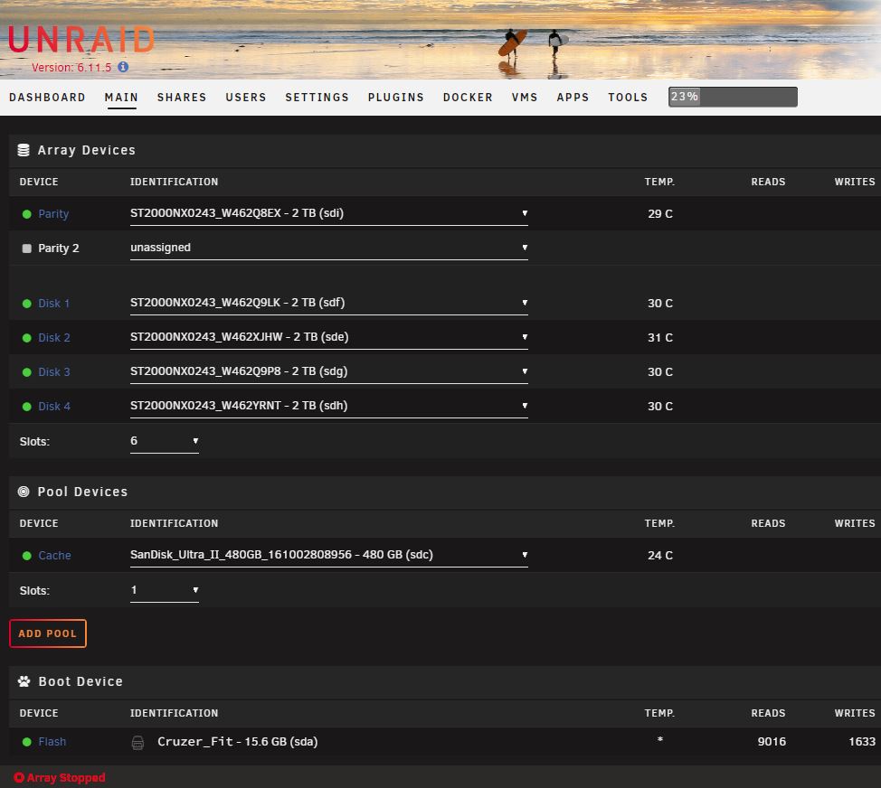

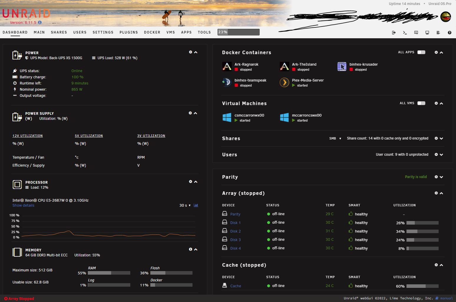

February 5, 20233 yr After upgrading to 6.11 everytime I reboot unRaid it comes up with the array not started. So I start the array and the UI reports that the array is not started. All of my dockers are working and both of my VM's are working properly. My drives are also working properly. I am hoping this is an easy fix. Thank you diagnostics-20230205-1600.zip

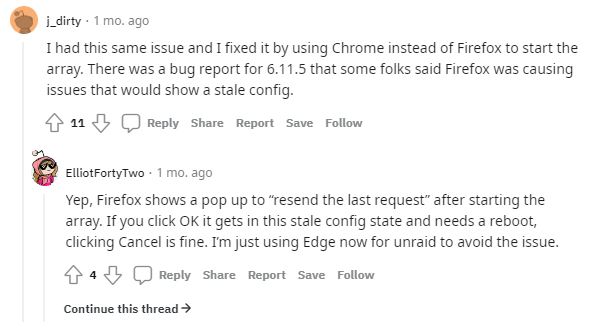

February 5, 20233 yr Author Solution Solved. Followed this post and was able to resolve the issue. I was actually having this issue with Firefox on the unRaid console after rebooting the server. Edited February 5, 20233 yr by csmccarron Added more information related to the original problem
