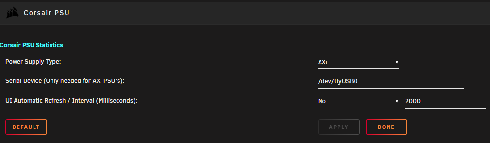

  5. PSU: CORSAIR AXi Series AX1200i Digital 1200W 80 PLUS Could not get the echo for unbind or bind to work. root@mccserverur01:~# echo -n "2-4:1.0" > /sys/bus/usb/drivers/cp210x/unbind bash: echo: write error: No such device root@mccserverur01:~# echo -n "2-4:1.0" > /sys/bus/usb/drivers/cp210x/bind bash: echo: write error: No such device root@mccserverur01:~# ls -l /sys/bus/usb/drivers/cp210x total 0 lrwxrwxrwx 1 root root 0 Jul 23 16:09 2-1.4:1.0 -> ../../../../devices/pci0000:00/0000:00:1d.0/usb2/2-1/2-1.4/2-1.4:1.0/ -rw------- 1 root root 4096 Jul 23 16:11 bind lrwxrwxrwx 1 root root 0 Jul 23 16:09 module -> ../../../../module/usbserial/ --w------- 1 root root 4096 Jul 23 16:09 uevent --w------- 1 root root 4096 Jul 23 16:17 unbind In order to get cpsumoncli to work I had to make it executable. root@mccserverur01:/usr/local/bin# cpsumon/cpsumoncli /dev/ttyUSB0 bash: cpsumon/cpsumoncli: Permission denied root@mccserverur01:/usr/local/bin# cd cpsumon root@mccserverur01:/usr/local/bin/cpsumon# ls -l total 16 -rw-r--r-- 1 root root 15760 Jun 15 08:01 cpsumoncli drwxr-xr-x 2 root root 60 Jun 15 08:01 libcpsumon/ root@mccserverur01:/usr/local/bin/cpsumon# chmod 755 cpsumoncli root@mccserverur01:/usr/local/bin/cpsumon# ls -l total 16 -rwxr-xr-x 1 root root 15760 Jun 15 08:01 cpsumoncli* drwxr-xr-x 2 root root 60 Jun 15 08:01 libcpsumon/ It is now working, except for getting 5v & 3v data. Thank you
  6. After installing Uassigned Devices Plus and Unassigned Devices Preclear, I was able to get the drive back to an unformatted and clear disk. I first ran the Preclear, then using Uassigned Device Plus cleared the partitions.
  7. I am having a similar issue. I have a Corsair AXi power supply. root@mccserverur01:/dev# lsusb -t /: Bus 02.Port 1: Dev 1, Class=root_hub, Driver=ehci-pci/2p, 480M |__ Port 1: Dev 2, If 0, Class=Hub, Driver=hub/8p, 480M |__ Port 2: Dev 3, If 0, Class=Human Interface Device, Driver=usbhid, 12M |__ Port 4: Dev 4, If 0, Class=Vendor Specific Class, Driver=cp210x, 12M |__ Port 6: Dev 5, If 0, Class=Human Interface Device, Driver=usbhid, 12M |__ Port 6: Dev 5, If 1, Class=Human Interface Device, Driver=usbhid, 12M |__ Port 6: Dev 5, If 2, Class=Human Interface Device, Driver=usbhid, 12M /: Bus 01.Port 1: Dev 1, Class=root_hub, Driver=ehci-pci/2p, 480M |__ Port 1: Dev 2, If 0, Class=Hub, Driver=hub/6p, 480M |__ Port 2: Dev 3, If 0, Class=Mass Storage, Driver=usb-storage, 480M |__ Port 3: Dev 4, If 0, Class=Hub, Driver=hub/5p, 480M |__ Port 1: Dev 5, If 0, Class=Human Interface Device, Driver=usbhid, 1.5M |__ Port 1: Dev 5, If 1, Class=Human Interface Device, Driver=usbhid, 1.5M root@mccserverur01:/dev# lsusb Bus 002 Device 005: ID 046d:c52b Logitech, Inc. Unifying Receiver Bus 002 Device 004: ID 1b1c:1c00 Corsair Controller for Corsair Link Bus 002 Device 003: ID 051d:0002 American Power Conversion Uninterruptible Power Supply Bus 002 Device 002: ID 8087:0024 Intel Corp. Integrated Rate Matching Hub Bus 002 Device 001: ID 1d6b:0002 Linux Foundation 2.0 root hub Bus 001 Device 005: ID 046b:ff10 American Megatrends, Inc. Virtual Keyboard and Mouse Bus 001 Device 004: ID 046b:ff01 American Megatrends, Inc. Virtual Hub Bus 001 Device 003: ID 0781:5571 SanDisk Corp. Cruzer Fit Bus 001 Device 002: ID 8087:0024 Intel Corp. Integrated Rate Matching Hub Bus 001 Device 001: ID 1d6b:0002 Linux Foundation 2.0 root hub root@mccserverur01:/usr/local/bin/cpsumon# cpsumoncli /dev/ttyUSB0 Corsair AXi Series PSU Monitor (c) 2014 Andras Kovacs - [email protected] ------------------------------------------- Dongle name: USB to SMB Bridge (Firmware by Ross Fosler) Dongle version: 5.3 Let me know if you need anything else. Thank you mccserverur01-diagnostics-20230723-1110.zip
