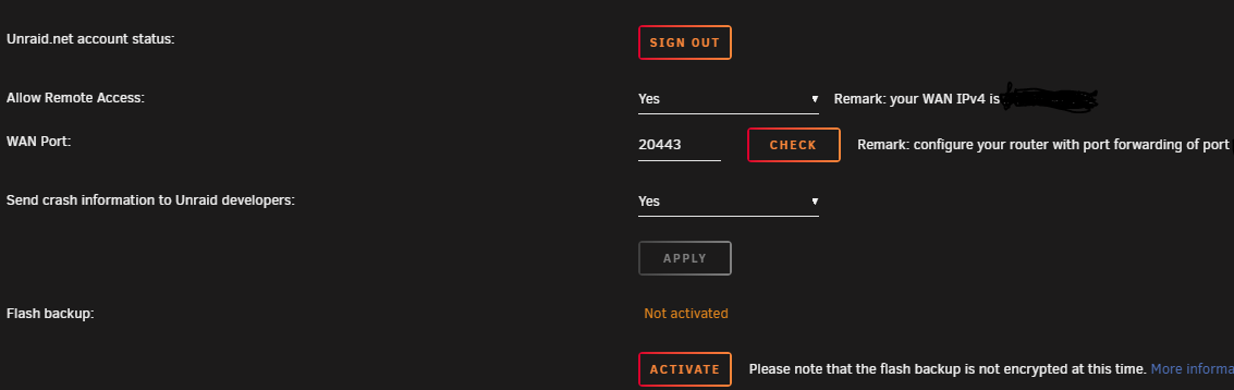

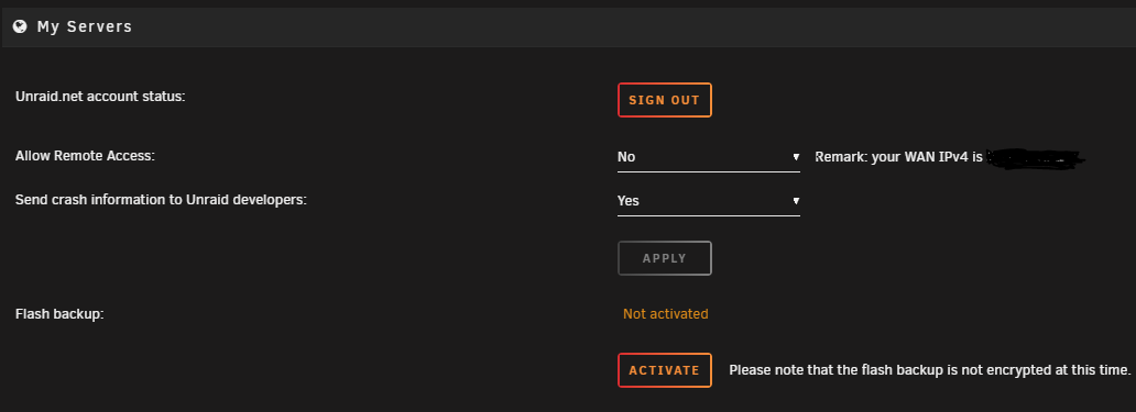

September 5, 20215 yr Author So my server has been up now for 17 days, no crash. So what do you want me to enable first? For now I am just going to install the plugin and leave that not signed in for about 7 days. After that I will sign in and disable the backup. Edited September 5, 20215 yr by csmccarron
September 15, 20215 yr Author Server has been up now for 26 days and 13 hours. I have had the MyServer plugin install but not signed in now since September 5 2021 with no issues. I am going to sign in but leave the backup disabled and see what happens. I am also leaving Remote access disabled for now. Edited September 15, 20215 yr by csmccarron
October 10, 20215 yr Author Server has been up now for 1 Month 20 Days 21 Hours 14 Minutes without crashing. Just enabled Allow Remote Access and will try this for a few weeks. The next step will be to turn the online backup on.

November 21, 20215 yr Author I have everything enabled except for the online backup and my server has not crashed. I need to enable the online backup. When I first installed the plugin the last entry in the log file was backup related and the server locked up. Since disabling the online backup my server has been stable.
November 21, 20215 yr Author I am off this week and intown, so I am going to enable the Flash Backup and see what happens. I am running UnRaid 6.9.2 and my My Servers plugin is up-to-date. As of right now the Flash Backup is Active. Due to a recent power outage my server has been up for Uptime 7 days 9 hours 38 minutes. Hopefully it will not lockup.
