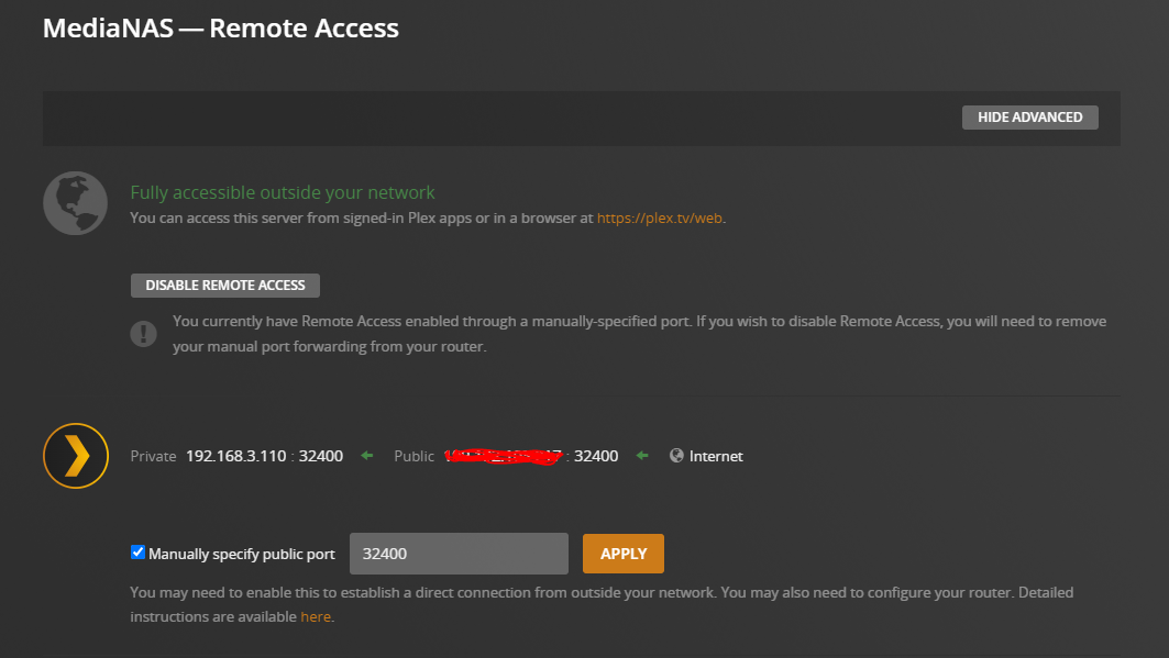

I am lucky that my UnRaid server is actually running fine, but friends are having problems accessing Plex remotely. I can access it through Docker no problem, and I can access the server over the LAN but anyone trying to access the server remotely cant connect as Plex doesn't connect to the internet.

Have you set up remote access in your Plex Server and are you forwarding the appropriate port in your router?
first plex must be on host connections settings in the docker and then you must forward your ports to plex's specific ip address which is the unraid ip address
i use a separate external port for my plex but most users should just forward 32400 and just use that
after you have fixed all your settings and port forwards then enable the remote access
