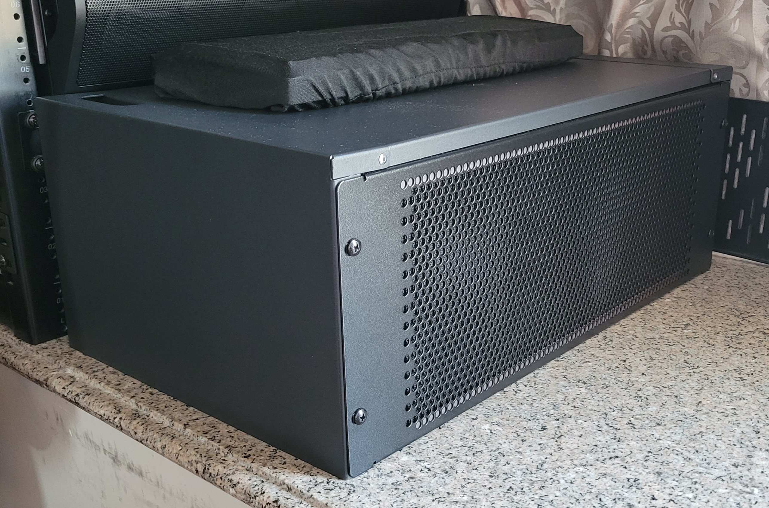

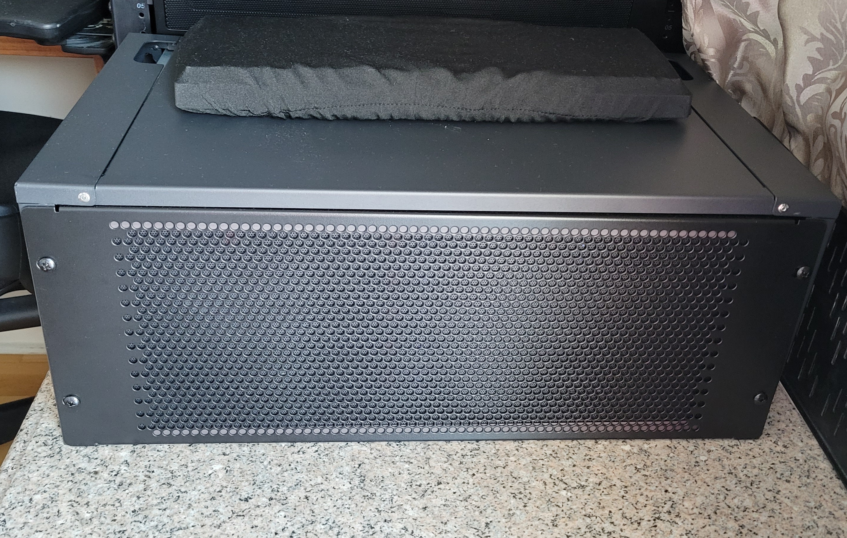

I finally manage to put something together, which looks good and works well. So as promised, sharing back
Here is what I ended up with
The parts I used are:
1. 4u vented panel with larger holes
2. PC mesh - large roll which I cut to 4u size, and stuck adhesive magnets on the border to stick with panel. It's right behind the panel.
I mounted them on a 4u wall mount frame which I just can lower as a cap (it has no bottom or back)
I was also planning to add a 140x3 fan wall between the panel and server in front, but my server fan wall behind the drives is doing a good job and Temps aren't affected, so I haven't pursued additional fans
Parts used are these. The mesh comes as a roll without the magnetic strip attached. It can be cut to custom size and then magnet can be cut and attached as a tape accordingly
