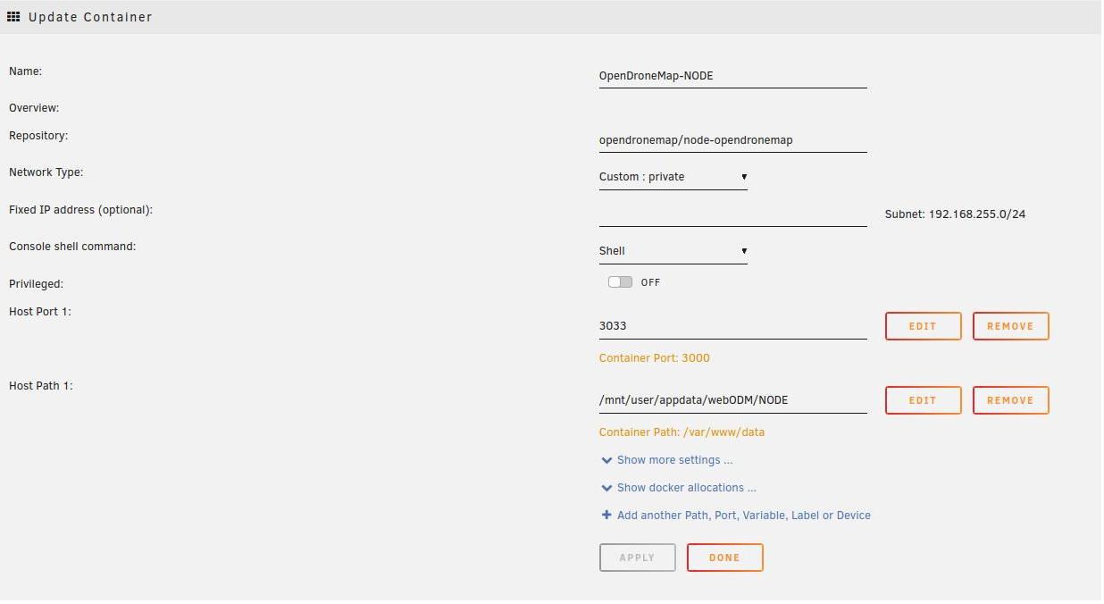

To get the Node running in docker select "Add Container"
and these are the settings that I used:
I dont know how to get these talking or anything about the program honestly.  This is a "botchy" install -sorry  :)
