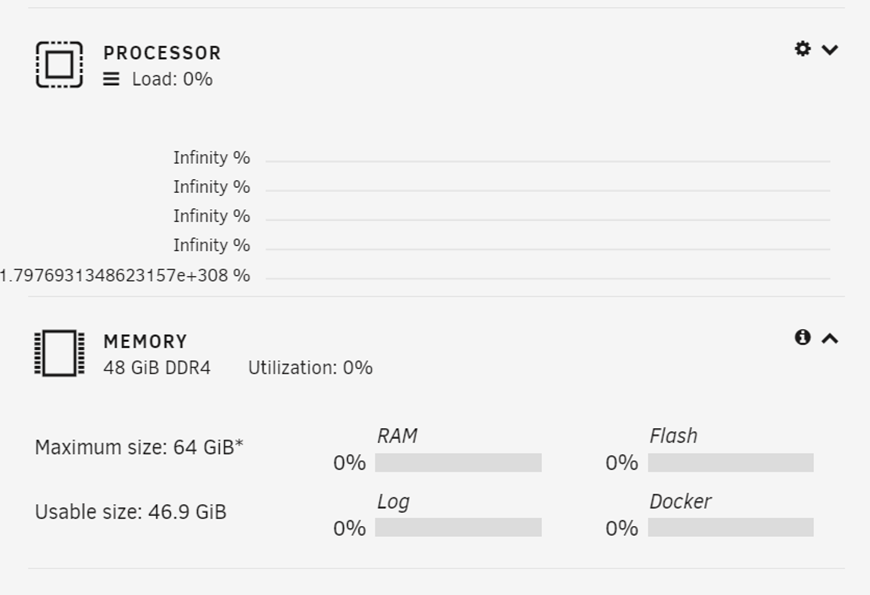

I've been having some stability issues with my Unraid setup lately. I actually upgraded the server recently which I assumed would probably resolve it, but its not, so I'm keen to get to the bottom of it, as I replaced pretty much everything in the process.

  • The Dashboard stops show certain data - notably Processor and Memory info is blank:

I'm continuing to get this issue intermittently. Yesterday I rebooted due to the server going into this partial failure state, and this morning I'm getting the same issue. Although the server is stable other than this, I'm clearly anxious that there's an underlying fault which will only get worse.
Given that I was having similar issues last year, my suspicion is that maybe the USB drive running as the array is failing - the two cache drives have both been replaced recently along with the server, so the USB drives used to boot Unraid and ru the array are the only elements that remain.
Any ideas on what I can try?
