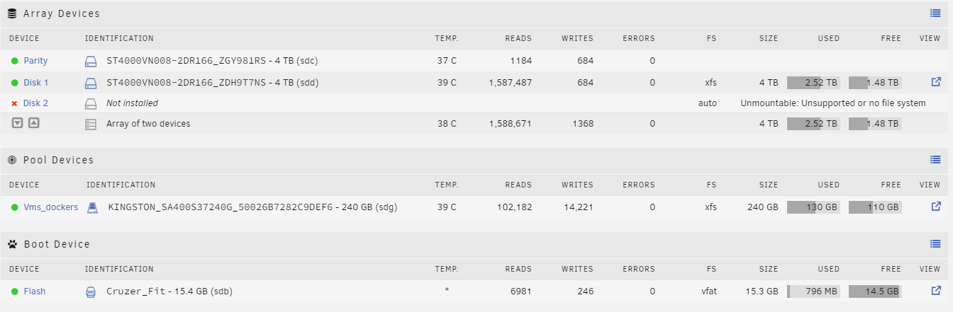

I have two HD, being. 1 parity 4tb and 1 data disk 4tb.
The data disk started to show problems.
I did the following procedure to change.
1) Step 2
I connected a new disk to the motherboard and did not remove the current one.
I stopped the array and added the new disk (I didn't remove the old one). So I was left with two discs of dates in the array.
Then I realized that I did it wrong, because I need to remove disk 1 and put disk 2 in its place.

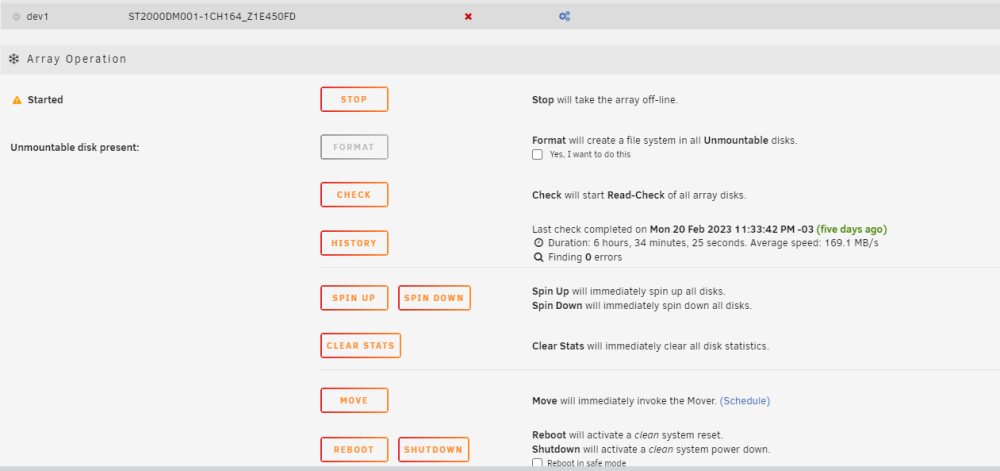

1) Step 3
I stopped the array and removed disk 2 from the array list (I selected the "no disc" option), but I didn't touch disk 1.
I restarted the server and turned on array.
1) Step 4
The files that appear in "shared" have a triangle on the icon.
I read on the unraid wiki they're not protected by parity, but they are there, nothing was deleted.
1) Step 5
I don't know what I should do right now!
My concern is if when I put disk 2 in, if new files were copied to it.
And what I need to do is swap disk 1 with disk 2.

JorgeB, I did the last step and now parity is ok.
Now, I need change disk1 to disk2.
On the Unraid website it says:
"Unassign the old drive if still assigned (to unassign, set it to No Device)"
I already connected the disk2 before power.
Now, I just need assign disk2 in place of disk1, or is need unassign (no device) before and restart server?
