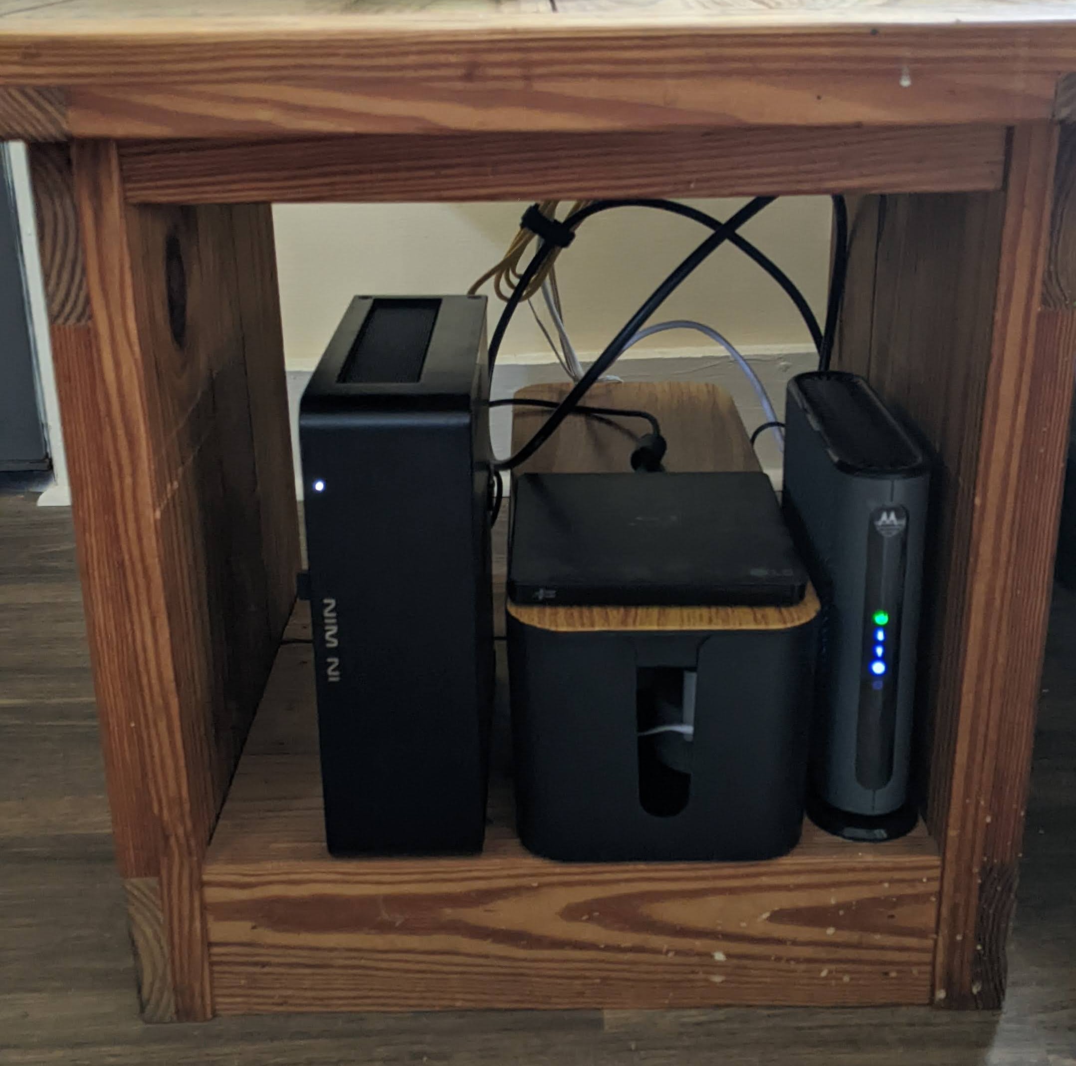

February 26, 20233 yr Author 15 hours ago, Lolight said: You might want to have more than one M.2 in your system (not in the array) that should be used for system app data, file transfers, Jellyfin metadata/thumbnails, docker containers, VMs - all of which would greatly benefit from being set on NVMe cache drives. e.g. you could use one cache drive for Jellyfin metadata/thumbnails, the other one for dockers/VMs and Appdata/system and the third one for downloads and then consecutive transfers to the much slower array on a predefined by you schedule. How much room do you have under that table? The Fractal Node 804 is less than 40cm tall. It also accepts cheaper and generally more suitable for NAS mATX motherboards (more SATA ports and NVMe slots). Quick measurement, it's about 14"W 14"D 13"H. My ATX Corsair case didn't fit, though it was definitely taller than the Node 804, I actually had the Node 304 on my short list. Here's the table with what's under there now: my InWin Chopin, cable management box with external DVD drive on it, and the modem (router's on top).

February 27, 20233 yr 6 hours ago, RebelLion1519 said: Quick measurement, it's about 14"W 14"D 13"H The Fractal Node 804 is about 13.5"W 15"D 12"H
