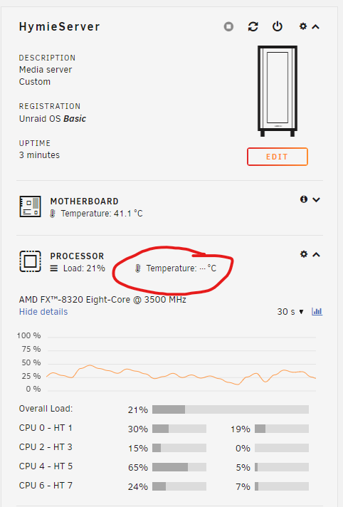

That's what I originally thought as well. Before posting this, I opened up the computer, cleaned off the dust from the CPU fan and re-applied thermal paste. It's still shutting down, but staying on for a few min first. And oddly enough, the CPU temp isn't being read.
In the screenshot your motherboard temp is 41.1c (106F), CPU could be warmer than that. If the machine was only on for a few minutes, as you mentioned, it's entirely possible you still have thermal issues. Your CPU load isn't that high either to warrant that MB temp.
Could be the CPU isn't seated properly and not making contact with the sensor.
