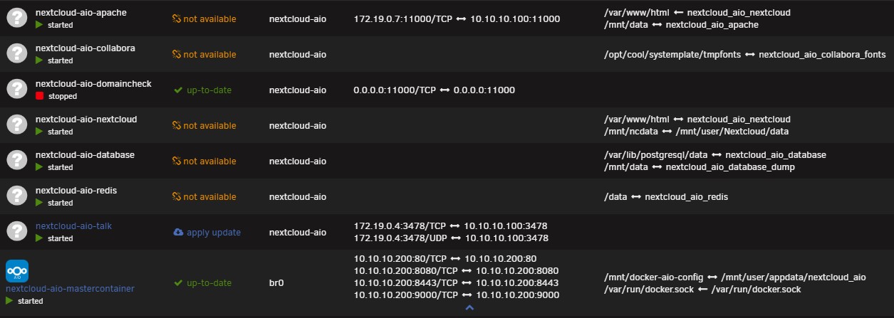

I went to install the nextcloud-aio-mastercontainer and for some reason or another I didn't fully finish setting it up. some time goes by and I go to finish setting it up and I can't get in because I forgot the long generated password and stupidly didn't copy it to a safe location. So I delete the containers to start fresh and now the database container seems to be in a boot loop. I can't access the logs because the window closes before anything can be read.
I think just deleting the local data would solve my problems. The problem with that is, I don't know where the local data is being stored. It just says " nextcloud_aio_database ". I take that to be the root folder? But I cannot find it. Any ideas on how I can fix this issue or where the local data is stored?

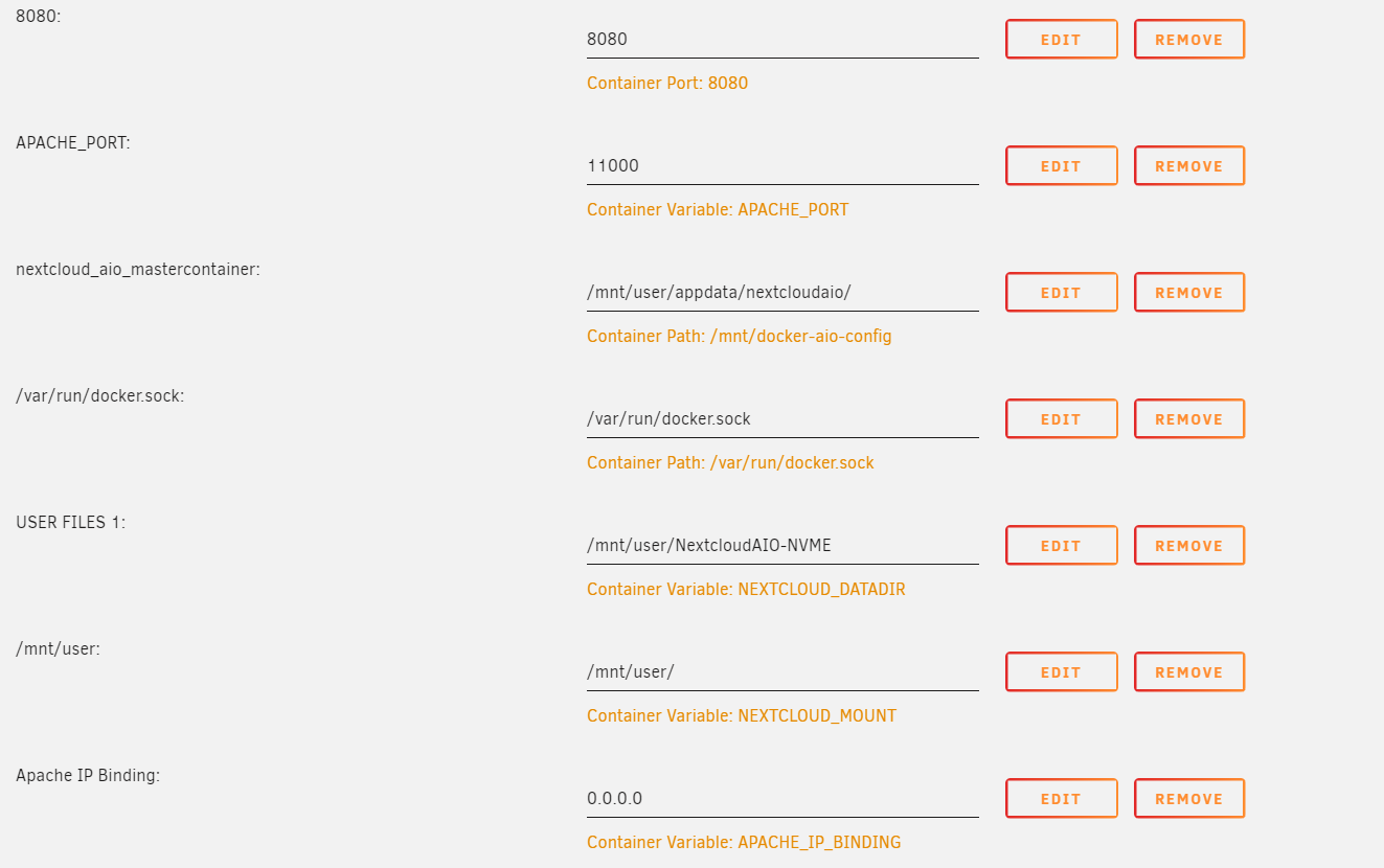

Hello Sorry for also hyjacking,
everything in my NC -AIO was running until I attempted an update then I also got the error below ==>
Trying to fix docker.sock permissions internally...
Creating docker group internally with id 281
It seems like you did not attach the 'nextcloud_aio_mastercontainer' volume to the mastercontainer?
This is not supported since the built-in backup solution will not work in that case!

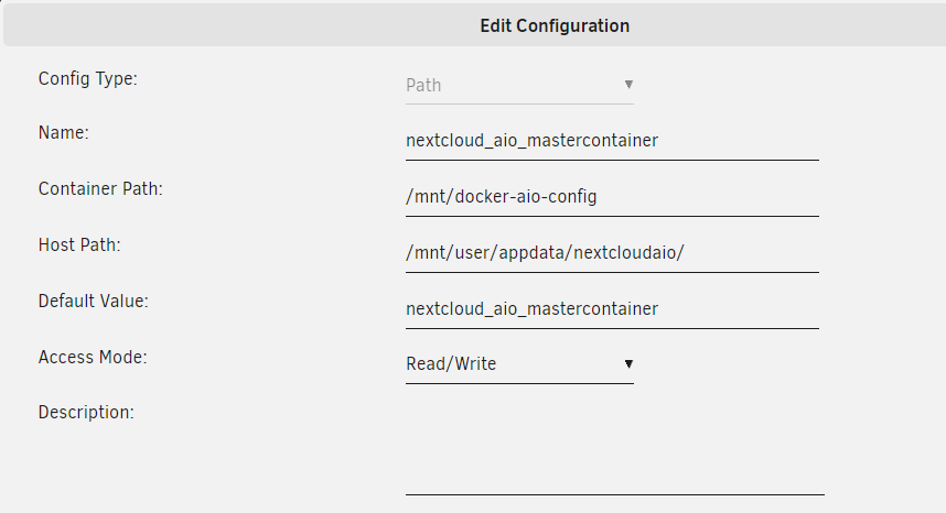

When you indicate the "Please change -v /mnt/user/appdata/nextcloud-aio:/mnt/docker-aio-config:rw to -v nextcloud_aio_mastercontainer:/mnt/docker-aio-config:rw "
how would I go about doing this change ??
Right now I can not load my AIO and am ideally not wanting to do a full re-install as original poster did If I can avoid this.
Do I have to change something in the Master Docker Container edit space (below)?  or in terminal window.  ?
If you want me to post my sudo docker inspect nextcloud-aio-mastercontainer  am happy to just let me know

4 hours ago, szaimen said:
When I understand you old config correctly, you most likely need to rsync the data in /mnt/user/appdata/nextcloudaio/ to /var/lib/docker/volumes/nextcloud_aio_mastercontainer/_data/ and recreate the mastercontainer with the correct command which should make things work.
sorry if this is a very stupid question but when you say "rsync" the data how would I go about doing that?
and when you say with the correct command are you talking about changing the line in the edit configuration at "host path " so that that would read "/var/lib/docker/volumes/nextcloud_aio_mastercontainer/_data"
Sorry again in stupid questions...
21 hours ago, Aceriz said:
It is something that I would change here ?
