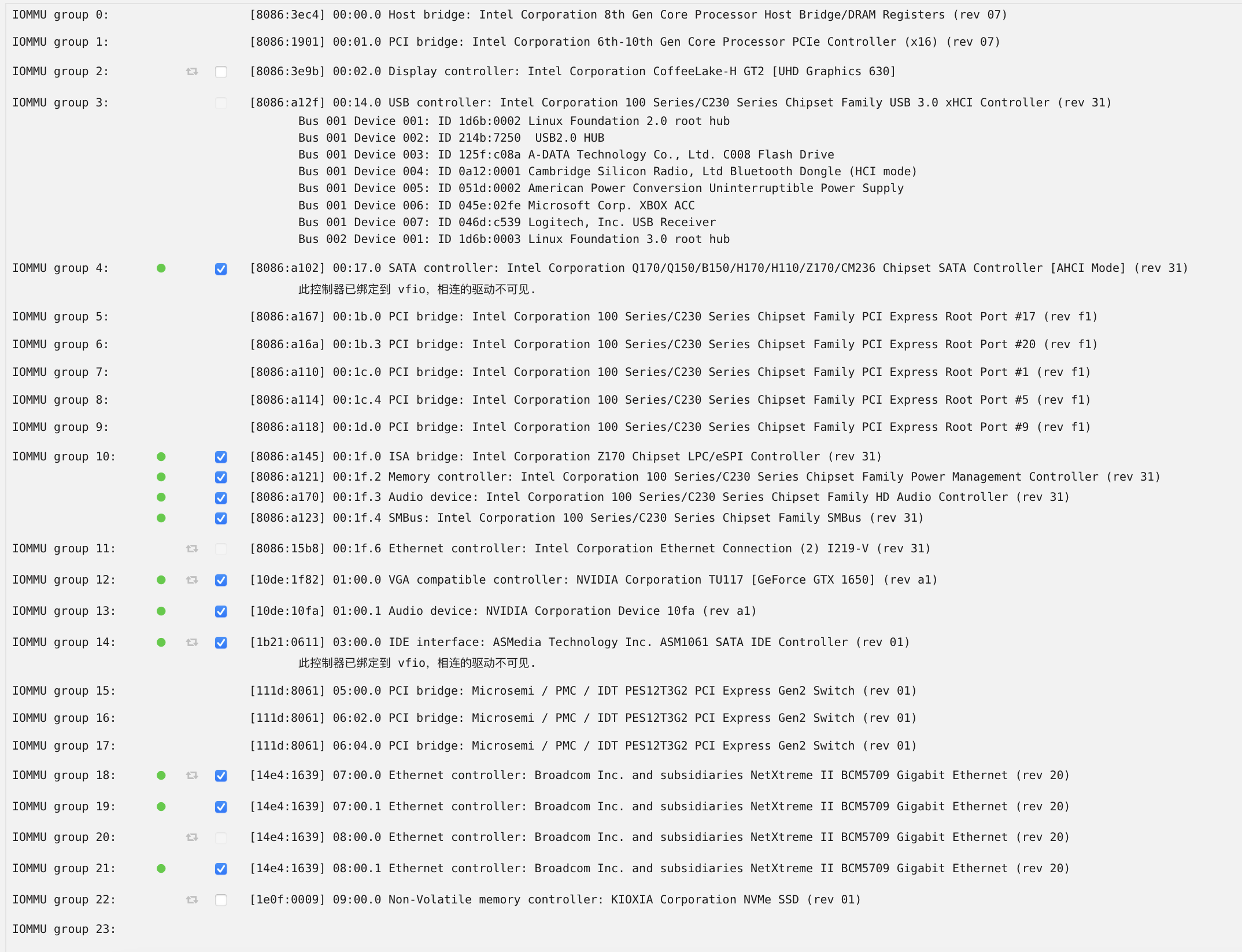

Thank you very much for your reply. I understand what you mean by backing up the vfio.pci.cfg file (mv) into vfio.pci.cfg.newbak. At the same time, I found that there are two other backup files in the directory. I haven't backed up this file before.
I restarted the computer after modifying the file and reset the vfio-bind. The problem reappeared after starting the virtual machine

I mostly told to rename that because of were passing though a lot of things, including an IDE controller, but looks like you need all that?
The NVMe is dropping offline once the VM starts, do you have PCIe ACS override enabled?
