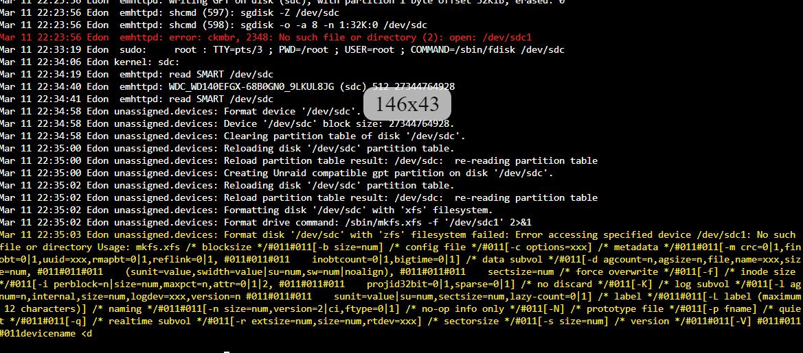

Hey all, I got a new WD Red 14 tb drive, and after plugging it in I'm getting the following error: Unmountable: Unsupported partition layout.
I've done everything I could find on the internet to try and fix it.
1.) I've created partition and used the unassigned devices tool to format it, which resulted in the following logs:
2.) I've removed all partitions and mounted the drive into the array, where it shows the error Unmountable: Unsupported partition layout.
3.) Verified that the mobo slot is set as SATA
I'm at a loss at this point and I'm not sure what else to try. If anyone has advice it would be appreciated.

Upgrade to Unraid v6.11.5, that release has a known issue formatting >2TB drives.
@JorgeBthat was it 🤦‍♂️. Thank you very much!
Solved!
