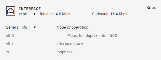

The issue at hand is that the integrated MB NIC seems to randomly cut out, leaving my with no network access to the web interface, and also no network connection on my VMs.
I have been trying everything I can think of, and also bought two USB NIC based on RTL8153, in order to attempt bypassing the built-in NIC. I'll get back to those.
The issue seems to occur randomly, and can be after either several hours to a day or so.
When it happens everything looks fine on the settings and such, except on the interface portion of the dash, where the connection speed is simply missing.
My priority is trying to get the integrated NIC working, with the USBs as a secondary solution, more on that further down. This screenshot is with the integrated NIC when the issue is occuring.

EDIT: Just remembered. The switch is only 1Gbit ports, so I'm thinking this is all moot and the fault is somewhere else. Or am I off?
