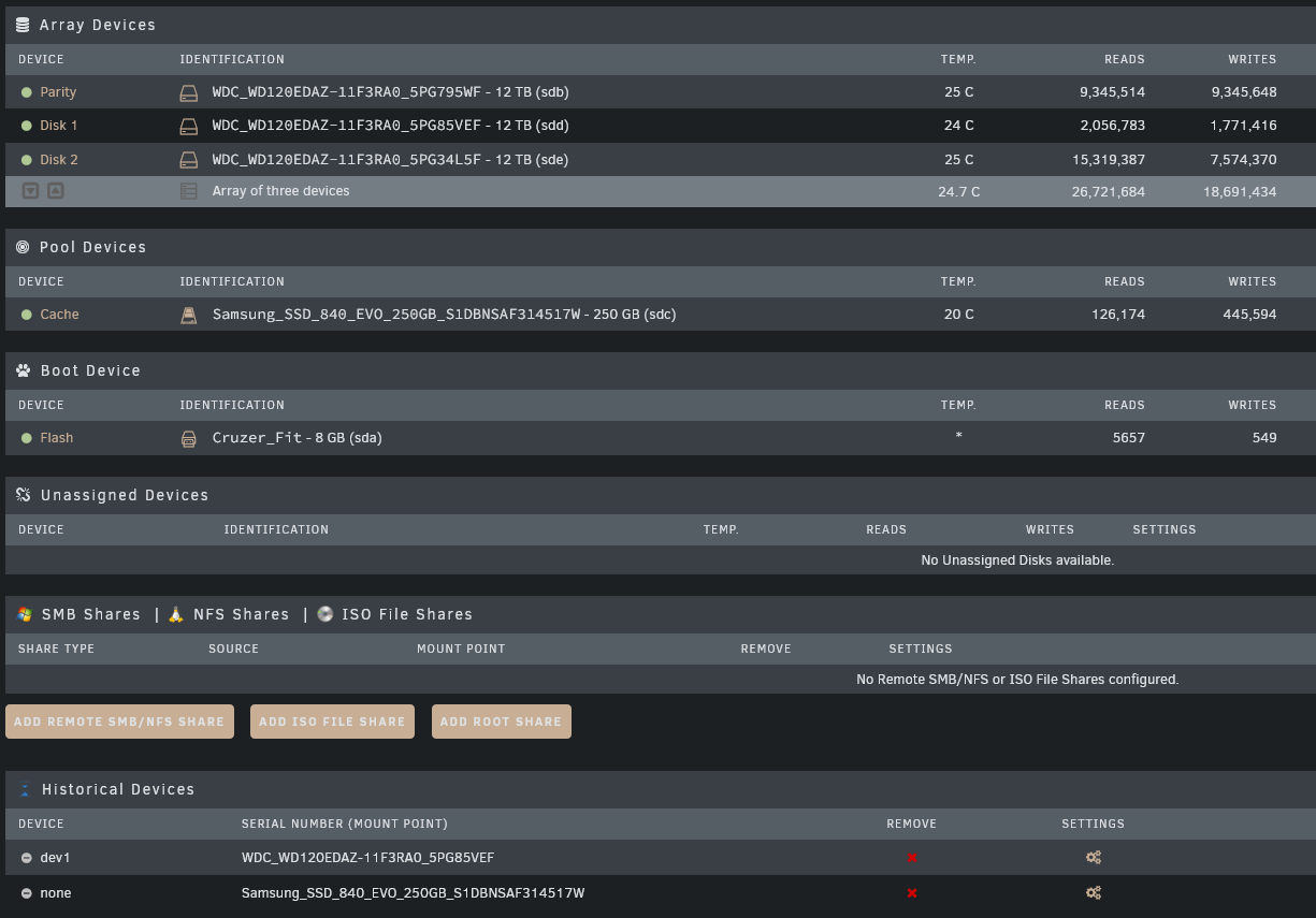

558657468_Screenshot2023-03-20at02-07-26.thumb.png.223c40e1272062da7b796aeb11c65e1e.png
On 3/17/2023 at 7:32 PM, JorgeB said:
If the emulated disk is still mounting you can rebuild.
Rebuild finished successfully. I was confused as to why I couldn't connect to mapped network drives afterwards, but soon realized it was because I started the array in maintenance mode.
Thank you for the help, JorgeB. 🙂
Is it fine to remove the offending disk from Historical Devices? Same with the cache drive in the attached picture. There's no point keeping either any more is there?
Yes, that's from the UD plugin.
