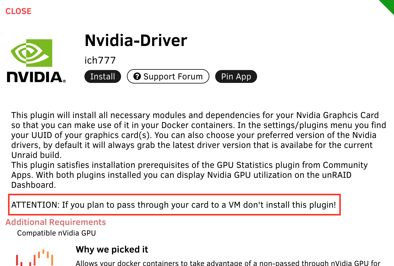

How do I go about setting up the Nvidia-Plugin? Per the plug-in install, it shouldn't be installed for pass-through to VM.
That stopped me too...

And you DID install the NVIDIA Driver App in Unraid?
No, that’s only if you want to use your GPU with a docker. If the GPU is being used by a docker then you won’t be able to do a pass-through to a vm, it’s either used with docker or passed through to a VM but not both.
For use with a docker  - Requires the NVIDIA Driver App
For use with VM as a pass-through - Don’t install the NVIDIA App
